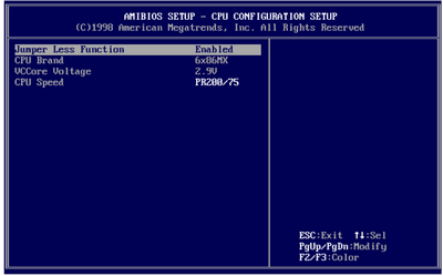

1. You are right, and I never said so. I just replied to Warlord's claim that because Ezra has a 10x multiplier it is automatically more suitable for speed sensitive games. I think that the available 2x multi in case of K6 is more important than the 6.5x-10x multis of Ezra especially with L1 cache enabled. And I just offered a tie, never claimed the Ezra is worse 😀.
2. Just for completeness: On K6+ you can enable/disable write allocation, write ordering, disable only L2 cache, disable L1 but enable L2, decrease the multiplier down to 2x and on motherboards like Zida Tomato you can also drop the FSB down to 50 MHz using BIOS.
3. I do not know other regions, but in Eastern Europe Zida Tomato boards were the cockroaches of late Socket7 era, they could be found everywhere. And the whole series has Jumperless/Auto -Jumper function:
37.46 KiB
488 views
4. Yes, Throttle with a compatible VIA chipset means heaven and earth difference if you try to achieve a specific speed point at the low end. It can be considered as an 1x-16x CPU clock divider in case of VIA.
5. Yep, I have never thought of K6 as a PIII killer...
