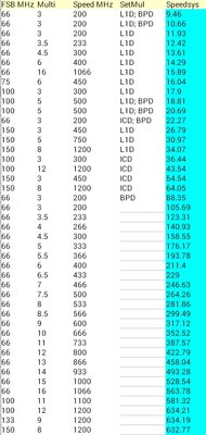

@squareguy: I posted this Speedsys table highlighting how smoothly the Ezra-T scales from around 9 to 632:
127.57 KiB
2890 views
The above is on a 440BX and S370. This is smoother than SS7 and K6-III+... It responds significantly with SetMul and ICD, giving this CPU an extra parameter for speed sensitivity. The main difference with Ezra and Ezra-T is that Ezra-T has a larger speed range with its 16x multi instead of 12x multi.
These CPUs don't have issues with Ultima 7 renabling L1 cache - suffered by Pentiums and K6s on SS7. This is due to ICD usage with SetMul.
FSBs can be changed In BIOS easily with more modern boards compared to SS7, and can be done on the fly with SMB DOS tool and a compatible clock generator. Overall, a more flexible platform than SS7.
