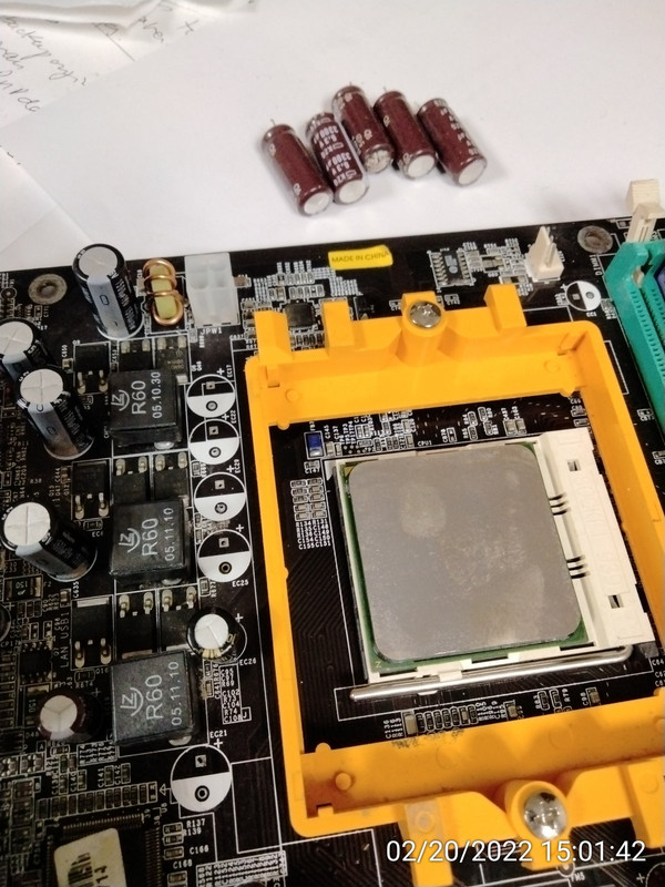

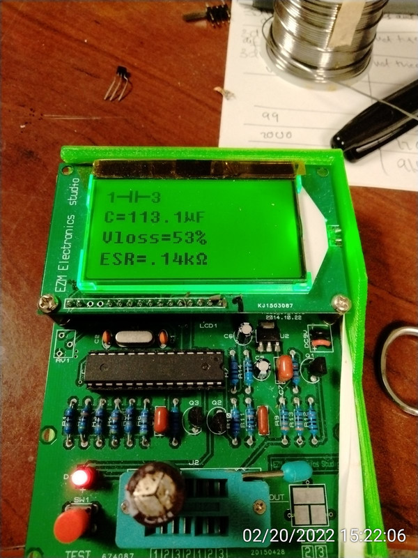

Reply 20962 of 30137, by stamasd
Recapping a socket 939 board.
Silly cap, you're supposed to be 3300uF, why'd you have to burst like that?

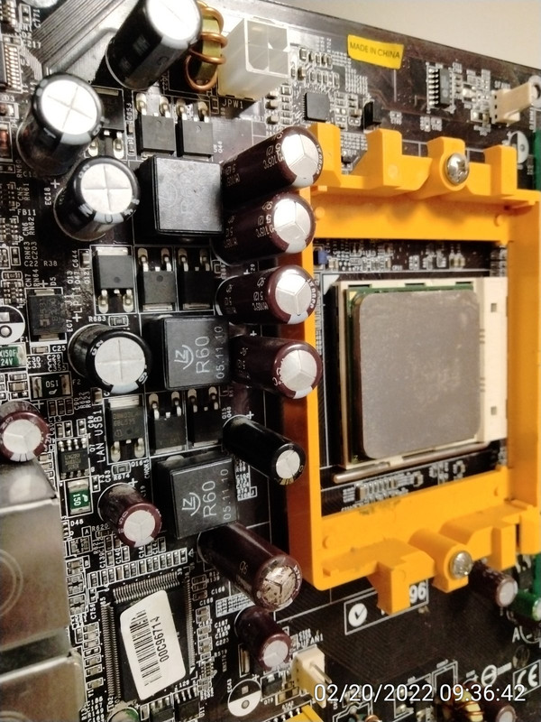

Those are probably low ESR capacitors. Make sure that you replace them with the right ones.
Reply 20966 of 30137, by stamasd
The ones I'm getting are rated for ESR of 0.015 ohms, should be good enough.

Reply 20967 of 30137, by stamasd
stamasd wrote on 2022-02-20, 21:25:
Recapping a socket 939 board. […]
Okay after recapping the motherboard, it works... sort of. I mean it works, POSTs and boots consistently, I can get into the BIOS without it freezing etc.
But it takes a very long time to POST. Like, 5 minutes long between printing the CPU ID and the moment when it starts counting memory. After it starts counting the memory, all is fine and proceeds at the normal speed.
And it does this delayed POST very consistently, every single time. I've never seen a motherboard do that.

Reply 20968 of 30137, by Nexxen
stamasd wrote on 2022-02-22, 00:15:
Okay after recapping the motherboard, it works... sort of. I mean it works, POSTs and boots consistently, I can get into the BIO […]
What happens if you press reset?
Cold boot, hot boot; resets? I guess you tried all already.

Reply 20969 of 30137, by stamasd
Reset gives cold boot. But even a warm boot (ctrl-alt-del after boot) results in the same long delay during POST. Just without memory count at the end of the delay.

Reply 20970 of 30137, by Kahenraz
I have a motherboard that I recapped which doesn't shutdown or reboot properly from Windows 98/ME. Shutdown will usually work but reboot will always hang the system on a black screen with a blinking cursor, requiring a hard reset. Either option will always trigger the startup scandisk which detects an incorrect shutdown (even though normal shutdown turns the computer off completely).
I only noticed this problem after I replaced the stock capacitors. I used genuine Nichicon capacitors ordered from Digi-Key. I don't know if the issue existed prior to replacing the capacitors since I hadn't done this exact test.
I have suspected that the capacitors I used as replacements are not low ESR, which is why I offered the warning. The ones I used are Nichcon HV(M) series which are marketed as low impedance. I'm not even sure if this has anything to do with the problem I'm experiencing, as I only have the one board.
Reply 20971 of 30137, by stamasd
Well I've cleared the CMOS a few times, didn't help. Flashed the latest BIOS version 1.D from the original 1.A and it also didn't help.
I noticed that during the time it waits during POST, if I press the NumLock key, all 3 LEDs on the keyboard flash, then go blank. Do this 5-6 times in a row, and eventually it continues to POST. So it shortens the duration of the wait during POST. Weird.
