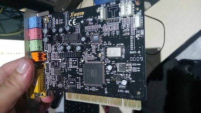

I would like to build a rig to be able to run both DOS [from 93' ish] and Win9x games.
SPECS:
Asus P3B-F Slot 1 with latest beta BIOS [Intel 440BX based]
512MB RAM
Pentium III 500Mhz Katmai [can set speed to 333Mhz from BIOS]
Voodoo 3 2000 PCI
Creative AWE64 CT4520 value ISA card
For OS I have an IDE2SD reader card with a 4GB SD card with Win98SE and another 1GB SD card with MS-DOS 6.22 with Phil's MS-DOS starter pack.
I have also the Yamaha YMF-724V PCI as per the attached photo, which I currently removed to make sure that the above is set correctly.
Excuse my noob questions [coming from the Amiga scene...], but can these be set to run in one machine and let me choose which I want to use ? For example the set the music to be output from Yamaha card and the SFX from the Creative card or I will complicate things more?
Maybe someone here hava a similar combined specs and can guide me please?
Thanks in advance!

it all comes down to resources
lets say the AWE is on Port 220, IRQ 5, DMA 1, High 5
and the YMF is on Port 240, IRQ 7, DMA 6 High 3
As long as the dos game allows you to select the card/settings you can tell it which port to use, say doom you would set it up something like
SFX= Sound blaster on Port 220
Music= General Midi on 240
Windows is a bit easier, go to device manager and select the primary device for sound and music and the game will usually default to that.
Some games wont play nice and force you to use the same card for everything, every now and then a game also may not like 2 soundacards for whatever reason.
If that's the case you can always disable one from device manager or not load the drivers in a dos boot menu
But a lot of us have 2 cards in a PC like this. PCI card for windows and ISA card for dos. My Slot 1 actually has 3 cards Onboard Yamaha YMF, Audigy 2 and AWE64 and all play nice.
PS I'm not saying use those specific settings, It'll depend on what works in your system, PCI cards especially can be very picky on what they'll work on

I was considering myself using SB AWE64 for digital sounds and using yamaha YMF744 card for getting opl3 in dos instead of the awe64 music. Is there any reason why this would not work?
Reply 3 of 9, by chinny22
Thats still fine, just as long as you point the games setup to the AWE's resources for digital sound and the Yamaha for the music .
Any game that only allows you to select 1 device for both sound and music you'll have to pick one card or the other though.
oh and Adlib games will use both cards simultaneously, just make sure to mute the card you don't want
Reply 4 of 9, by Gmlb256
Better yet, disable the AdLib port on the AWE64 which is possible to do in both DOS and Windows. This way you won't need to be adjusting the mixer of both sound cards in case you want to use the EMU8K capabilities of the AWE64.
