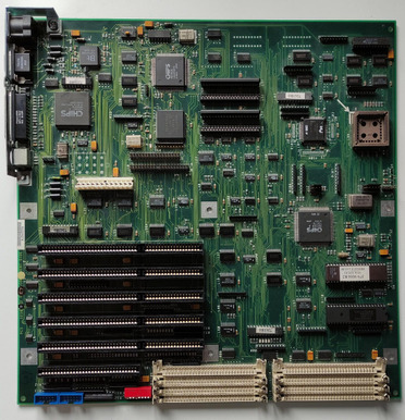

Hi all,
Bought a 386sx motherboard which seemed in a fairly acceptable state given the pictures of the seller.
Unfortunately upon arrival it's not, e.g. some of the socketed chips were reversed in their sockets, and I think they even got switched.
Also no jumpers and a microswitch box all in a "zero" state.
I browsed through all of stason.org to see if I could find the board and know how it should be configured (jumpers, switches).
Unfortunately no luck there, also a reverse image search didn't give the result I needed.
Please help identifying this fairly unique board:
- 1x 8-bit slot
- 5x 16-bit slots
- on board VGA (Chips & Technologies)
- on board I/O (C&T or NEC?)
- Has larger DIN for keyboard, but also ps/2
- 2x4 30-pin memory banks next to eachother
- i386sx CPU
Thanks for your help!

Thanks imi, I figured it would be some brand specific - hoped someone around here would be in for a challenge 😉
Dimensions are 330 x 330 mm.
It further reads PCS 3238 and then I guess revision D2 on the edge.
I'm not aware, nor could I find such brand 'PCS'.
The print doesn't state a year anywhere, though I would expect it to be late 80's or early 90's at most.

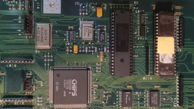

The system does not boot, and I have no experience or tools to read such a chip.
I think the Intel P8942AH is the bios, as the other one is clearly the VGA bios.

If you've got a nice magnifying glass, you can take off the sticker off of the bios eprom. It likely has the UV window to erase it, looking through that you might be able to see damage.
Like is visible in this image.

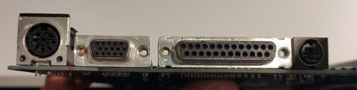

The i/o panel has:
- 'keyboard' connector with 8 holes + gnd (on my 486 there are only 5 + gnd)
- VGA connector
- LPT connector
- ps/2 connector

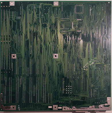

On the backside it reads 3238-2 PCS / Made in Taiwan / Circuit side.
Furthermore it has markings KR / MVO 4791 and two stickers: sticker RI 35 WLT-0077-3 / sticker QC 13 WLT-0077-6

I had a hunch about that din connector ^^, looking at the board closely again I think this might be a video output as well
that might give some more clues as to the origin of this board.

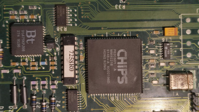

Worst part is on the 'Chips peripherals controller and Bt VSP' image. Some of the connecting lanes have dark spots. Also the back of the LPT port and the crystal in the op of that image has some corrosion.
Do you think this would cause the board not to function? What is your opinion on replacing the crystal? That's something I could try.
