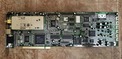

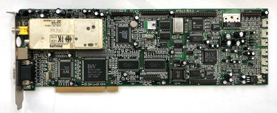

This story began as a search for PCI card FUJITSU SCENIC MEDIA EXTENSION BOARD D971 for one of my "projects". This is a rare computer card, even pictures of it on the web turned out to be extremely small. By the way, I'm still looking for it 😉
Looking for full-sized FUJITSU PCI card, it is clear from parts of the text on the web that there are TV tuner and 3D sound "expander". I found the Brooktree card at one of the local auctions in Ukraine.
This card had a TV tuner and a large number of chips, obviously redundant for simple TV viewing. Carefully examining it, I began to collect information about what kind of card it is and whether it is an analogue of the one I'm looking.
Original photo from auction attached.

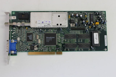

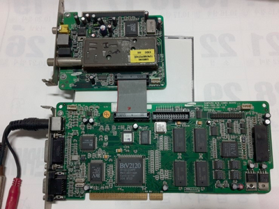

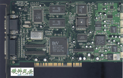

Photo of several video cards on Brooktree BtV21XX chips - Brooktree Durian (developer board?), Number Nine 9FX MEDIA 574, STB VIDEO RAGE, Samsung SCM-1000
    158.87 KiB
    1710 views
    39.43 KiB
    1710 views
    627.14 KiB
    1710 views
    188.15 KiB
    1709 views

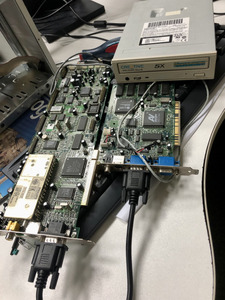

First "power on" and compatibility with TFT monitors.
1) LG IPS226 - no image, no signal found
2) NEC 18880SX - the image in text and graphics modes "flicks" at least once or twice per second, the image brightness is normal in all modes. After installing the video card driver in Win9X, the SVGA graphics modes work fine.
3) SAMSUNG 510T – the image in text and graphics 320x240 modes is excellent, the image brightness is normal in these modes. When you try to set the graphics mode to 640x480x16 colors (standard VGA), the image brightness drops by 99% (it seems that the monitor simply turns off the matrix backlight). After updating the video card BIOS to version 5.8.9 and installing the video card driver in Win9X, text and graphics modes work fine!
4) JVC LM-15 - an old but professional reference monitor with a VGA input and two analog composite TV inputs - works perfectly in all modes without restrictions and additional settings.

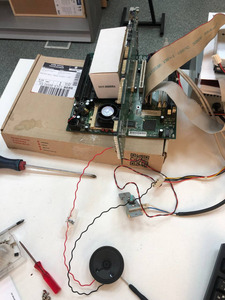

OH YES!
I found the sound output and I can hear it!
Currently PC-Speaker with the right channel only, need some connectors and soldering)))
Its a SB Pro with hardware original Yamaha OPL3 under DOS and SB Pro/OPL3 with software 8MB wavetable under Windows.
