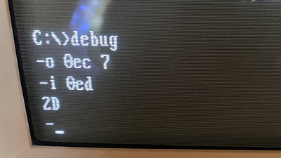

Reply 72 of 90, by zyga64
I also wanted to try what you are doing, on my computer with a 286 on a VL82C311L 😀
I have PCCHIPs M218 - looks like this one: Re: PCChips M218 286 motherboard info needed
On this motherboard BUSOSC (pin121) input is connected to 14.7 MHz signal, and ISA CLK signal (in PIN B20) was half of that (measured by osciloscope).
So it looks like divider was set to 2 (reading from CLKCTL register gives me 4 - which means divider is 2 when BUSOSC is not connected).
Then I lifted up BUSOSC pin and ISA CLK signal on PIN B20 becomes 20MHz 😀 Computer still booted normally but very fast !
Now Wolf3d demo is 13.9 FPS... (CL-GD5422)
But I assume that this is not very safe setting, so I lowered it to 10MHz this way:
c:\>Debug
-o fb ff
-o ec 7
-o ed c
-q
Dummy write to FB port (in my case 0ffh, but can be anything) enables write to Configuration registers. (dummy write to F9 port disables write to those registers).
Then I wrote 0ch (00001100) to CLKCTL register - setting up bit 3 - sets clock divider to 4 (40/4 = 10 MHz).

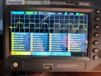

Reply 75 of 90, by zyga64
@Marco
1. Desoldering (using flux) pin from board, and moving it slightly up (by tweezers) at the same time. Pin121 is located on the corner of the IC, so it was relatively easy.
2. You may try (carefully) to do as I did. Floating BUSOSC is in high state 😀 If the system gets up after this operation, you will be able to change divisors in debug 😀
3. Yes. Checked by oscilloscope on ISA PIN B20. System (DOS 5.0) seems perfectly stable, but right now only VGA and Multi I/O cards are put in. More to test 😀

Reply 76 of 90, by Marco
@zyga64:
I might try first mkarchers proposal as I feel more comfortable than soldering that fine in first place.
Regarding point 2: this might not work for me as isaclock seems to be SYSCLK (=40MHz/2 for you). On my end it would be 27,5MHz (as I use a 55MHz osci). I see veryyyyyyyyy little change for that 😀
SHORT OFFTOPIC:
Btw if you could run another benchmark at 20MHz bus I would be interested to compare with mine (just short off topic).

Reply 78 of 90, by zyga64
Marco wrote on 2023-01-21, 18:16:
SHORT OFFTOPIC: Btw if you could run another benchmark at 20MHz bus I would be interested to compare with mine (just short off t […]
SHORT OFFTOPIC:
3d bench (slow pcs): 9,9
Pcpbench vga: 2,1 forget that one. Requires dos extender
With 20MHz ISA clock (div/2): 7,5
With 10 MHz ISA clock (div/4): 7,3
With 6,66 MHz ISA clock (div/6): 7,0
Almost no change. CPU bottleneck 😀
