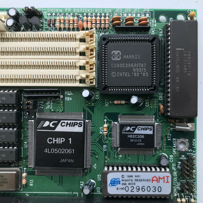

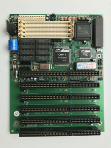

I am getting a PCChips M218 Version 1.2 286 motherboard. I have been unable to find the jumper settings for this board. I was able to find the jumper settings for a M216 & M219 on the www.ultimateretro.net website. I assume the jumper settings for those boards are probably very similar to the M218. Any help would be appreciated.
Reply 1 of 20, by Deunan
Can't really help with the jumpers but I do have questions:
- Is that an 80287-10 next to 20MHz 286? This actually works?
- There seems to be 1MiB of DRAM in sockets?
I don't see parity chips for the on-mobo DRAM so it's a good candidate for those "new" 4MiB SIMM sticks? But then again it would need two, and 286 with 8MiB (well, 9 in total) seems like a waste.
Reply 2 of 20, by jasa1063
Deunan wrote on 2022-02-08, 14:53:
Can't really help with the jumpers but I do have questions: - Is that an 80287-10 next to 20MHz 286? This actually works? - Ther […]

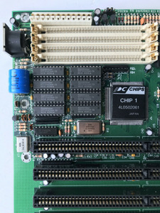

I haven't gotten the board yet, but here are two more pictures with closeup views of the ram and 80287. The pictures are from the seller I am getting the motherboard from.
Reply 3 of 20, by snufkin
Most of the jumpers look labeled and are the front panel connectors .
JP9 and 12 look to be Turbo Switch and Turbo LED
JP10 Mono or Colour graphics
JP13 Reset
JP11 Speaker
JP14 (?) Power LED and Keylock.
JP4 by the PSU connector looks like an external (pin 1&4)/internal (pin 1&2) battery selector, and at a guess it'll also work as a clear CMOS jumper by moving the jumper to either 1&2 or 3&4 (whichever of pin 1 and 4 is the ground, I think pin 2 is the battery +ve pin, so clear CMOS might be 3&4).
JP2&3 might be to select which RAM banks are active.
Can't just see where JP1 is and JP5,6,7,8 aren't fitted. Maybe they're something to do with enabling/disabling the co-processor.
[edit: oh, there it is, over by the barrel 'o doom battery, hard wired as 2-3. No idea about that one.

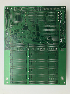

Oh, and on the battery, top of board looks fine, but there's what looks like some minor damage to a trace on the bottom, so you may want to remove the battery and give that area a clean.]

Reply 6 of 20, by snufkin
Looks like JP5 had something soldered to it at one point, so if you do take the existing NPU out then it might be worth trying to trace what JP5-8 connect to.

Reply 8 of 20, by jasa1063
jheronimus wrote on 2022-11-25, 04:41:
I'm setting up this board right now. Haven't figured out the jumpers yet, but they do affect the amount of RAM the system sees when SIPP modules are installed (got 5 megs recognised only when the jumpers are set like in your picture, otherwise it's 640K or around 2.5 megs). So two theories so far is that they either affect memory banks 0-3, or change waitstates (RAM from 0 to 1, ROM from 2 to 3).
I'll benchmark the system with various jumper settings to test the waitstates theory. However, this board with the same chipset does have two jumpers to switch between RAM configurations. https://theretroweb.com/motherboards/s/biosta … r.-01#downloads
Have you been able to find the EMS driver for this chipset? I've been looking everywhere without success 🙁
The PC Chips M218 uses the VLSI VL82C311L "SCAMP" chipset. I have been able to get a full 16MB of ram working by changing the JP2 & JP3 jumpers which control the ram banks used. As to an EMS driver, I found one but have not had any real success getting it to work. I am uploading a copy in the hope you can figure out how to get it working. Here is a post on the DOS Days website which mentions the PC Chips M218 motherboard and some performance info:

Reply 16 of 20, by megatron-uk
The 32MHz can is almost certainly to drive an FPU at some integer division of 32mhz.
Quite a few later/higher clocked 286 board have an option to run the fpu at either a fixed division of the main CPU clock, or at another frequency via an additional oscillator.
Most of the original 286 fpu designs were never intended to run at such high frequencies, so additional options were needed.

Reply 18 of 20, by megatron-uk
Unfortunately I was never able to get mine to work.
I suspect that because the board was so warped/bent that there are internal traces which are broken. I'm no electrical engineer, so it's possible it's repairable.
Lots of examples of boards from that seller (when they were still available to the EU/UK) with similar damage and removed components.
I just don't understand the desire to remove caps and oscillators and not the other parts.
https://www.target-earth.net
Reply 19 of 20, by CzasowAnton
Hmm... I don't think that mainboards like this has layers with traces inside... Except +5V and GND... Do you checked chipset's pins? May be they are teared off from the board because of bending (or just the time, or both 🙂) and needs to be soldered again... First it needs to be checked for continuity with multimeter (painstaking work a little bit).
And resistor arrays ("black lines" on the board) for proper resistance, may be somewhere it's broken...
