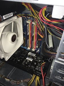

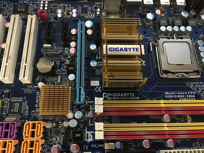

I've had a bunch of parts sitting around not being used and have decided to build an "overkill" Pentium 4 machine running Windows XP.
Specs:
Intel Pentium 4 661 (3.60GHZ, LGA775)
Gigabyte GA-P35-DS3R Rev 2.0
4GB DDR2-800 RAM
120GB Kingston SSD
Geforce GTX770 2GB
There is also a 3.80GHZ 775 P4 available from Chinese sellers on ebay but the prices are silly.
For fun I'm going to run benchmarks to compare the performance with the GTX770 to a 750TI and a 710 (all 2GB versions).
Why am I doing this? No idea, I just have a weird nostalgia for the P4 era and was very annoyed with my RD-RAM P4 build not being able to have 2GB of 1066 RD-RAM, so I'm taking things up a level with a 775 CPU and DDR2 memory.

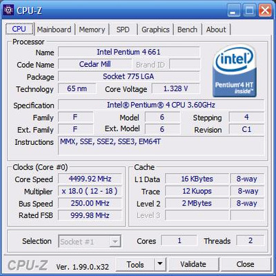

Cedar Mill can go up to 4.5Ghz relatively easy. After that, required voltage rise will lead to quite high TDP, but 5Ghz is totally possible on air.
That's hilariously awesome.
I will definitely try for more later today.
EDIT - 4500 seems stable so far!

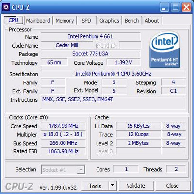

4.68 boots into windows with 1.4v vcore, it does bluescreen crash when trying to run anything CPU intensive though.
4.75 doesn't finish booting windows and gets an IRQL_NOT_LESS_THAN_EQUAL bluescreen.
It's so silly having a p4 at this clockspeed, youtube is very usable now! (at 720P, 1080P is a no)
Should I go much higher on the cpu voltage? I didn't play around with these processors much back in the day, don't know what their limits really are.

Reply 18 of 64, by The Serpent Rider
You can push it around 1.5v safely, if cooler is capable enough. Heat dissipation won't be pretty and you need to stay below 70C.
Reply 19 of 64, by pete8475
The Serpent Rider wrote on 2022-11-27, 15:24:
Well I have fairly chunky tower cooler on there, I'll see what happens with 1.5v!
EDIT:
This is so silly, so far we're up to 4787mhz. 🤣
