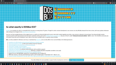

Reply 1506 of 1571, by Falcosoft
morphinejh wrote on 2022-10-19, 13:50:
.... More details here: https://yesterplay.net/dosboxece/ […]
More details here:
(it does look to be down at the moment though)
It's not down per se but it has a certificate error:
The attachment ece1.png is no longer available
To be honest I never understood the Google forced https everywhere movement. Why should a simple download site that does not require any user login/data be available only through https and redirect any http connection attempts to non-working https? (It uses HTTP Strict Transport Security policy.)
So you should try an alternative browser that still enables you to add an exception even in case of non-working certificates and HTTP Strict Transport Security (HSTS) sites.
Website, Youtube
VST Midi Driver Midi Mapper
x86 microarchitecture benchmark (MandelX)
Reply 1507 of 1571, by morphinejh
Falcosoft wrote on 2022-10-19, 14:05:
Good point, I updated above. I don't use Chrome directly, but rather one of its Chromium variants. I can advance through it manually, but didn't want to post that as instructions per se.
