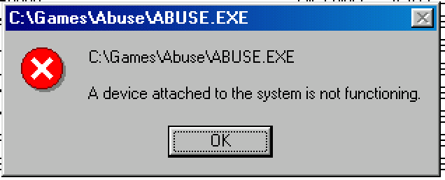

Reply 2341 of 2447, by Alevam-Inc.
Can anyone please help me? None of my games will launch anymore, I just get this error message:
