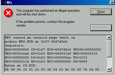

I'm getting illegal operation errors when attempting to install or play Need for Speed 1 SE in PCem. The setup is a P mmx 200 with voodoo 3, running Windows 98 SE.
The attachment Screenshot 2022-11-30 181900.png is no longer available
The attachment Screenshot 2022-11-30 181826.png is no longer available
I was using driver 1.07. I also tested 1.01 but no change.
When I switch to Virge DX the game works fine.
Does anyone know if this behavior happens on real hardware? I have to check before filing a bug report.

I think it's a Windows/DirectX incompatibility with most of the problem being the Windows version of NFS is difficult to get working outside of an early Windows 95 environment. What version of DirectX do you have installed?
Reply 12 of 18, by eddman
Meatball wrote on 2023-03-23, 01:55:
Thanks for the test. It happens with older versions too, including 98 SE's built-in DX 6.1a. It seems the installer checks DirectDraw compatibility/features and doesn't like something about Voodoo cards. It even happens on 98 FE with DX 5.
It looks to be an actual compatibility issue, and not emulator related.
Reply 13 of 18, by NostalgicAslinger
As i remember: The Windows version of NFS Special Edition only works on one of my faster retro PCs (Pentium MMX 233 with Ati Rage IIC works fine), if I reduce the hardware acceleration of the graphics card in Windows 98 from 100% down to the half or None. The Setup Program starts after reducing and I could install the Windows version.

NostalgicAslinger wrote on 2023-03-23, 17:10:
Would be interesting, if there are some speed changes, compared to the DOS version. Windows version uses DirectX 2.0?
This works, Thanks!
I didn't go through the Windows install process, but instead just copied the NFS_WIN.EXE and IFORCE.DLL files over to the DOS install. Files are all the same, otherwise and the game will run with hardware acceleration slider over to 50%.
EDIT: Actually, I just realized there is no sound (DOS mode has sound, though)! So, close... oh well. Man, this game is a piece of work, ha!
ANOTHER EDIT: I'll try reinstalling and see if that changes anything.
FINAL EDIT: No change, perhaps the eddman will have better luck!
