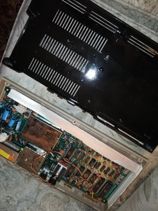

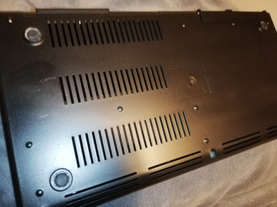

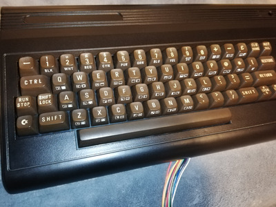

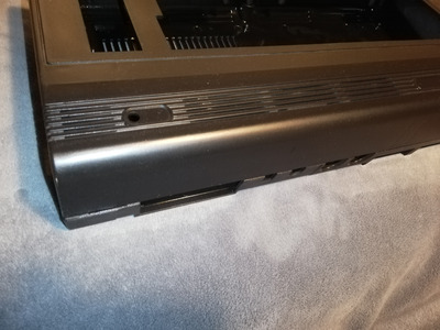

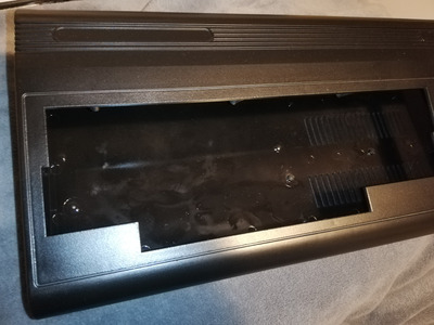

Hi, yes. I've painted an old C64 just recently and remembered your question.
Pictures attached. My other "works" are stored in cardboard boxes..
PS: The painting was done with cheap acrylic paint here, because I'm used to it.
Automotive paint or another highwr quality paint might be a better choice.
I applied a few thin layers of paint dust essentially. With each layer drying about, um, 20-30min?
A few days later, I did the same with transparent acrylic paint. It acts as a simple protective layer against scratches.
I did the paint job outside in the garden, on an old wooden table, on a sunny day.
Edit: To those of you worrying about "destroying" a C64 case.: It's just paint, please don't worry.
The black colour scheme isn't that bad, also. It's not that historical incorrect (no sacrilege), as it may seem at first.
Some sister models, like C16, were also available in black.
On the bright side, a paint layer also protects the otherwise aged, brittle C64 chassis from further exposure of oxygen.
The black also goes well with the keyboard colour.
That being said, new, fresh C64 chassis are being made again. They use official Commodore forms and good plastic.
So it's no tragedy if some old chassis are getting altered by enthusiasts.
The C64 was mass produced like the original Gameboy, there's no eminent shortage.
