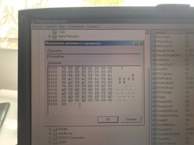

Guys I’ve got a laptop with Yamaha 754, and it feels that music and some sounds are clipping despite the volume level in windows. I definitely remember this was a discussed issue and there was a Japanese tool to correct the volume on low level. But I can’t find it now, maybe you can help me?
Reply 290 of 355, by vorob
Crackling may be caused by too high maximum volume. Sometimes it's because driver allows to set the volume too high, when it was taken from another card. With VxD drivers you may fix it in registry: HKEY_LOCAL_MACHINE\Software\YAMAHA\Driver\YMF724\VolumeMax, or by YMF7x4Utilities.
What exactly should I change here? Thx.

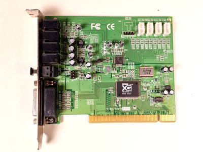

Reply 298 of 355, by GunKneeNeon
Tertz wrote on 2016-05-15, 18:02:
YMF7x4 chips have no regulators of timbre or equalizer. But some codecs support this and card's vendor drivers may allow this. For example, Genius Sound Maker 128XG has it on its 1040 drivers.
Hi, where can I find this specific driver? I got a Genius Sound Maker 128XG recently. I googled around and cannot find this driver. There is generic yamaha ds-xg 1040 driver, but it doesn't have the equalizer thing(or am I missing something?). All vendor drivers coming from Genius for this card that I can find are WDM ones(version 22xx).
Constantly looking for the driver for Acer Magic v1 MPEG decoding card.

I also don't know what model it is. I'll attach a photo to help identify.
