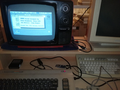

Reply 10 of 22, by Jo22
That reminds me of GEOS on my C64..
I still need to get a GeoRAM module or any of these REUs. ^^
