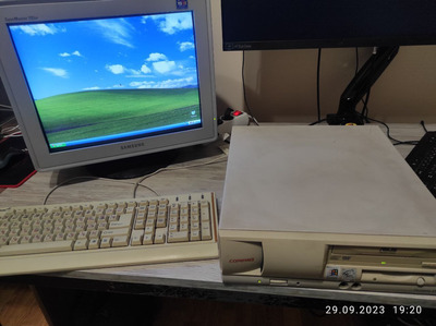

This PC had Windows XP installed with drivers for the sound board on MB. It worked fine but DOS doesn't see it.

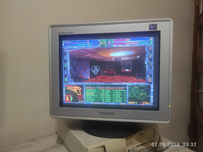

The game in one of the photos was launched on the other PC.

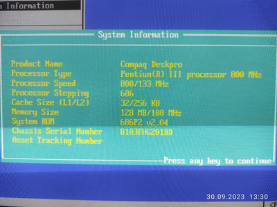

Please post the specific specs of your system including what sound cards you are trying to use.
It also looks like you only have PCI slots. PCI sound cards are generally more difficult to get working under DOS.

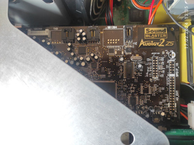

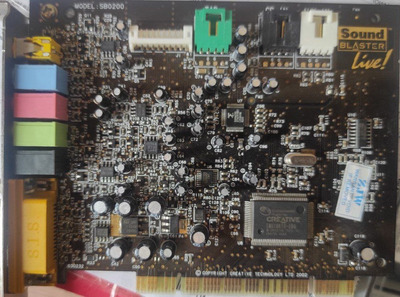

I attached a report from microsoft system information on Windows XP and photos of my sound blaster boards.
Also I installed drivers from kxproject and WDM is working now on Windows XP but I want it to work in DOS in Windows 98. If I manage to install Windows 98SE then I will post an update.

Hmm...I don't think the Live board has DOS support, it would run under Windows though, if the game can use DOSBox in a Windows environment?
(It could be the same with the Audigy 2, but I've never used one myself.)
Reply 8 of 15, by Jo22
Hi, I've found a bit of information about the card at Phil's website.
https://www.philscomputerlab.com/sound-blaster-live.html
There seems to be a DOS driver, but I don't know how it exactly works. 🤷‍♂️

Both cards will work in Windows 98 and Windows DOS mode. The Audigy 2 ZS is a pain to install though. Follow Phil’s YouTube instructions for both cards and disable as many resources as possible in the BIOS (as suggested previously).

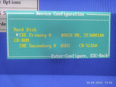

On Compaq Deskpro EN SFF with i440BX and onboard ESS 1869 it is essential to turn off the onboard sound card via "Device security" for Audio (BIOS option), if you want use PCI soundcard. I dont know, if it is same with your machine, but you can check this.
Reply 14 of 15, by megatron-uk
Hold on, that machine has an ESS 1869 integrated in it? I would think that would be the easier option to get working in DOS than a PCI Soundblaster.

Thanks to all for the participation. I was able to install the drivers for Audigy ZS using the ones from philcomputerslab. The sound is working fine but not in System Shock and also the game crashes after clicking "START" on Win98. In dos mode it crashes after the Origin logo. But it's another issue not for this thread. Probably System Shock 2 will run fine on this PC.
