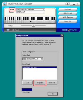

6. Using a higher quality soundfont
6.1 Go to the D:\DOSDRV\SF2 folder and copy all the .SF2 files from there to C:\WINDOWS\SYSTEM
6.2 Go to the D:\DOSDRV\ECW folder and copy all the .ECW files from there to C:\WINDOWS\SYSTEM
6.3 Start > Programs > Creative > SoundFont Bank Manager
6.4 Click on "Bank" then click on the default soundfont (2GMGSMT) to select it, then click Replace, select C:\WINDOWS\SYSTEM\CT8MGM.SF2 wait a few seconds until it loads then click Ok
6.5 Open C:\WINDOWS\CTSYN.INI in Notepad and change this line: Waveset=C:\WINDOWS\SYSTEM\default.ecw to this: Waveset=C:\WINDOWS\SYSTEM\EAPCI8M.ECW
6.6 Save the changes you just made to CTSYN.INI then restart your computer
6.7 Run your favorite DOS game and in setup choose General MIDI for music
The attachment SFB_Manager.jpg is no longer available

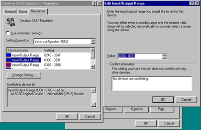

Reply 2 of 589, by crvs
For those who have several sound cards installed, it's also possible to setup SB16 emulation with non-default settings
I have patched VxD from Audigy2 ZS driver CD ISO in order to modify MPU-401 and Adlib ports
  • Input/Output Range: 0330-0331 => 0320-0321
  • Input/Output Range: 0388-038B => 0288-028B
Other parameters of the driver can be changed in Windows Device Manager; this should resolve all conflicts

Using the original drivers, right click on My Computer > Properties > Device Manager > Sound, Video and Game Controllers > Creative SB16 Emulation > Properties > Resources and uncheck "Use automatic settings". Then, choose "Basic Configuration 0002" > Change Setting.
This will allow you to manually change any settings except for the Adlib port (0388-038B). If you already have a different Adlib device installed (from a second sound card) it will show a conflict, but that won't affect the playback of the secondary sound card in any way.
You can also choose "Basic Configuration 0004" which will completely disable the Adlib port on the Creative SB16 Emulation device while leaving the MPU-401 available for General MIDI via soundfonts.

Reply 5 of 589, by Joseph_Joestar
crvs wrote on 2020-06-14, 15:14:
Any settings besides Adlib (0388-038B) and MPU-401 (0330-0331).
I can change the MPU-401 settings without any issues.
The attachment 009.png is no longer available
Did you follow the steps I posted above? Like I said, you need to use "Basic Configuration 0002" for this to work.
