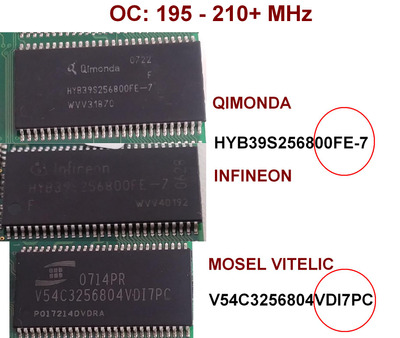

V) And finally the EXTREME ones. Those are the best in my experience (from 195 up to 210+ and more...)
Qimonda: HYB39S256800FE-7 datasheet
Infineon: HYB39S256800FE-7 datasheet
Mosel Vitelic: V54C3256804VDI7PC
It's easy to notice that Infineon's and Qimonda's chips are labeled the same;) From what I understand, these companies merged at some point and then one completely absorbed the other one.
There were only 5 memories that exceeded 195 MHz at CL3-3-3-7 on my ABIT ST6 and I would like to focus on them 😉 The first one MOSEL V54C3256804VBT7PC did only 197 maximum:

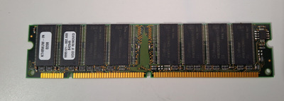

Below there is a list of memories from the same manufacturers but with different markings and stickers and you can see how they overclock:
HYNIXes:
INFINEONs:
Microns:
Samsungs:
MOSELs:

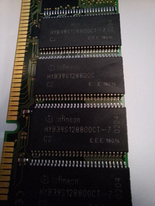

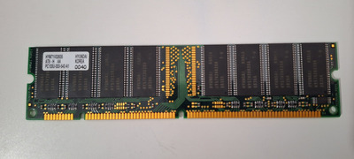

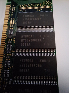

Hello everyone,
I found a couple of these ram sticks that I'm not using.
Anyone interested?
Each stick is 256mb
1 x Hyundai HY57V28820A T-H
1 x Infineon HYB39S128800C -7
