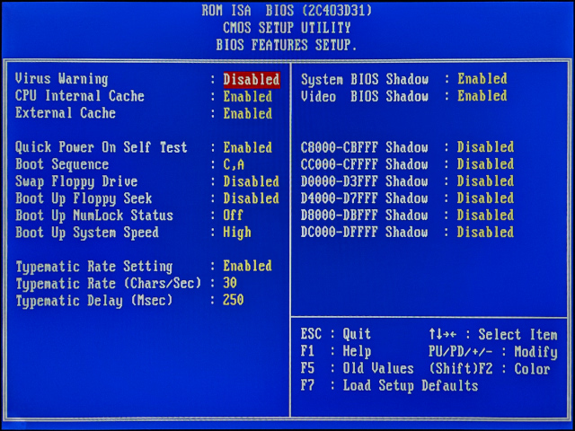

The board came with an impressive ATT BIOS - lots of options. Check it out:
No, i didn't forget to provide the rest of the screenshots.
That's it.
Luckily there is an AWARD BIOS available.
Provides decent amount of settings.

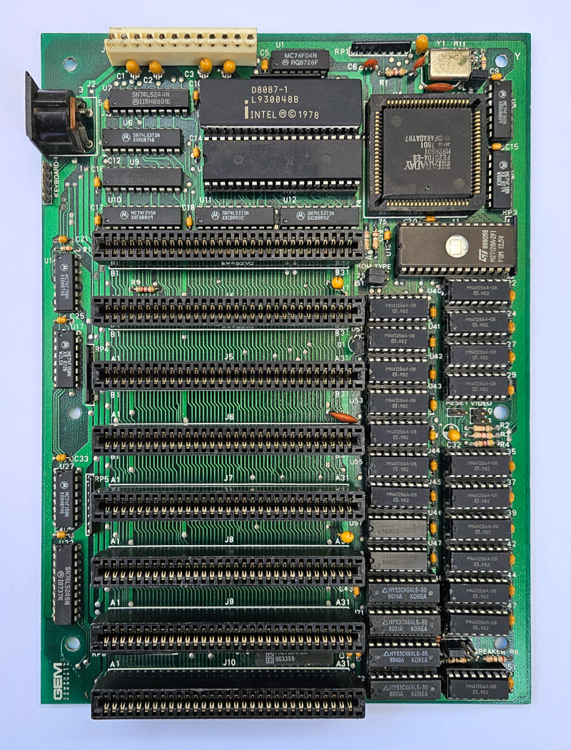

GEM Computer products GEM-10 based on FARADAY FE2010A-ES
Cute, very compact 8088 assembly.
Been with me for quite some time but sat in the pile of dead components because it came DOA.
I remember trying to resurrect it multiple times, but without success.
Multimeter and oscilloscope probing all checked out, rotated multiple sets of trusted components, but no signs of life.
Yet my sixth sense insisted the board is not dead.
Last week i was exchanging components with somebody and needed a specific type of DIP-16 RAM chips to accompany another 8088 board i was sending to him.
Found them on this GEM-10 guy. After the extraction i was about to throw it back in the junkyard when my sixth sense kicked in.
Scraped few more RAM chips for 256Kb memory buffer. Power connector in. Video card in. Power-on - monitor lit up.
For my great surprise and pleasure.
No idea why it came back to life and how, but hey, i take it.
I was so interested in what the Faraday silicon can do, finally had a chance to find out.
The system runs at 9.54MHz.
According to this page
Faraday FE2010A can provide 4.77 MHz and 7.15 MHz CPU clock frequencies using 14.31818 MHz crystal oscillator, or 4.77 MHz, 7.15 MHz, and 9.54 MHz CPU clock frequencies using 28.63636 MHz crystal oscillator.
Interestingly enough the bard starts without the presence of the 28.636MHz crystal oscillator in the upper right corner, but the XT-IDE controller never starts initialization.
Also, using crystals with higher frequency than the default one still results in 9.54MHz to CPU.
This was the part i wanted to validate. Did now - 9.54MHz is the max.

Reply 2134 of 2164, by rasz_pl
pshipkov wrote on 2024-04-07, 22:38:
wait, what? I dont see any other clock sources on board
as shown by utilities, right? thats because main clock influences all the timers 😀 so CPU runs faster but so does integrated 8253. All benchmarks run will give results tainted by this effect. Only way to measure performance is with a stopwatch 😀
At 9.54MHz this motherboard is below average performer, but still faster than 10MHz Juko ST (CPU-12 and some of its derivatives).
you need to calculate how much faster hardware timer works, then multiply all the results by this ratio.
Reply 2135 of 2164, by pshipkov

Reply 2136 of 2164, by pshipkov
feipoa wrote on 2024-04-07, 23:07:
And you still don't own a Voodoo2?
I have Voodoo 1 card, not used, and Voodoo 3 in the LSD 200MHz hotrod - fits very nicely there.
Tried few times to get energized about Voodoos but doesn't click.
I guess my attention is mostly on professional 3D graphics hardware, or consumer products that can function in that role.
I agree with ChadTi99 that adding some standard glide tests to socket 3's would be of interest. Between the Voodoo1, Voodoo2, and Voodoo3, it would be best to select the card which works well on most PCI based socket 3's - so either the Voodoo1 or Voodoo2, with Voodoo2 yielding better performance.
We can certainly use a set of additional Glide tests to further validate stability, but from what i see here and what is evident from your post on the subject - the 486 class hardware is too slow to keep these cards busy, so the difference in performance between Voodoo 1/2/3 is negligible.
What you think ?
retro bits and bytes
Reply 2137 of 2164, by pshipkov
@rasz_pl
So, without a crystal the Faraday chipset produces frequency of ~4.11MHz on its own.
Unfortunately IDE/FDD extension cards don't work without a crystal, so POST stops after RAM count and keyboard controller check.
I don't have crystals that cover the space after 28.636MHz space with enough granularity.
So, i can check 30MHz and 36MHz only. At 36 POST does not complete. At 30 there is virtually no perf difference compared to the standard for this board 28.636MHz, especially if we consider that there is a human error on the stopwatch. But also, the system gets flaky even at that moderate overclocking.
