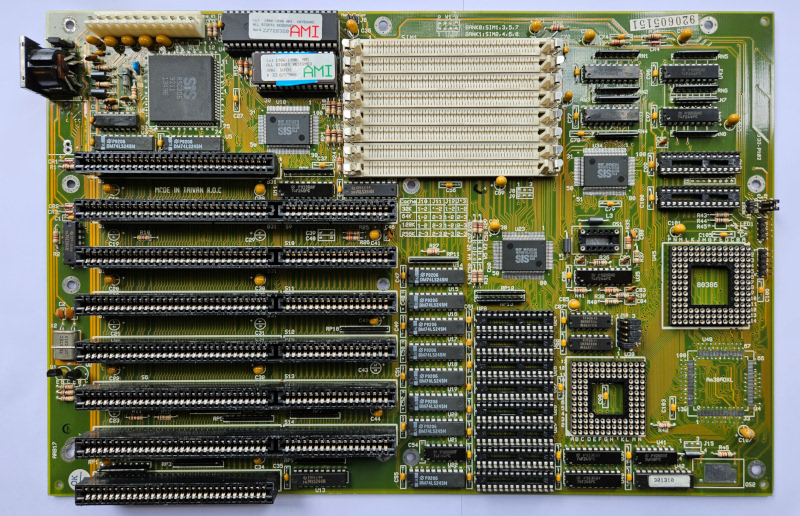

A while ago, I happened upon perhaps one of the oddest 486 boards to date.
AFGJ81rM4e1Ye1Js1fmMHpd46haFATw0wuGJOXCYgawmfHT5P3SQ5rHzg4MTy8BIirk-Xu5O4iNoGZLCIojgXsjouVhincn6gA=s1600
This story starts with ALD-the manufacturer of this board. ALD's designs are perhaps some of the strangest out there, notably defined by cheap, highly-integrated assemblies. One rather infamous ALD board is the VL4200, a single-chip VLB board based on the 93C413 chipset. It supposedly can support cache, but comes laden with fake cache ICs and does not seem to support real cache, even when modified.
I realized this thing needed a manual, so I emailed ALD. Their website still exists, and it looks to be straight out of 1997. Their support actually had the manual, and it has since been uploaded on TRW as a PDF. Talk about a good (and quite weird) start to an otherwise fascinatingly strange saga.
The ALD PCI 5433 is a based on the single chip ALD 93C488 chipset, and boasts numerous features that sound to be little more than marketing fluff. One such feature is the "latest Pentium class technology...Pipeline Burst Synchonous SRAM Cache...," which happens to distinguish this fellow as the only known 486 board with pipeline burst L2 cache. This made such an assembly quite interesting, as it raised numerous other questions, such as: How flexible is it? How true is the claimed PCI 2.1 compliance, and how is its PCI implementation in general? Is the ALD 93C488 something that happens to be re-labelled, or is it truly an in-house single-chip 486 solution with all the bells and whistles, from WB L1 support to pipeline burst cache support to even EDO support?
Well, it's probably best to sum these answers in a few words: yes and no. Yes, it's an interesting board and, comparatively, it is decently fast. To say that it is speedy is a stretch; it's probably in the lower tier of SiS496/UM8881 boards, and that might be the whole story for you right there. However, as they say, there's always more to the story-and with this ALD fellow, there certainly is. I suspect that more can come of this assembly in the future.

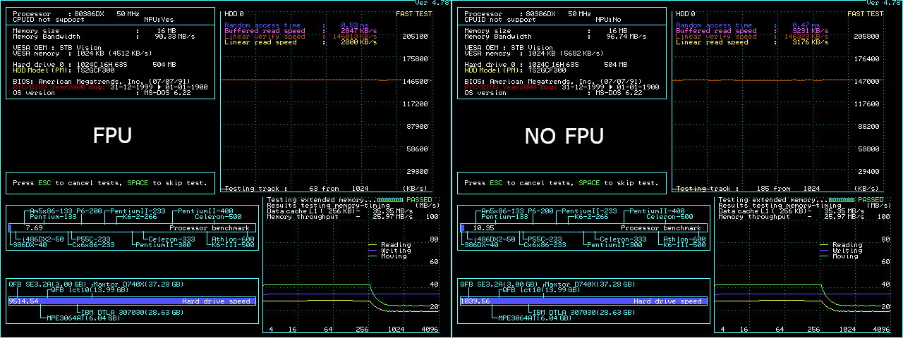

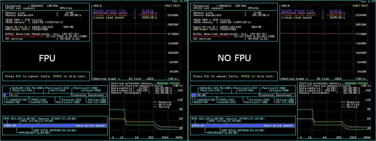

Results follow below. DOS performance was enough for me to call an audible on this one as far as further testing goes. I can provide performance numbers for Windows if so desired, and I can try 3D rendering, but it seems to me that this assembly is just too far out there to be worth examining further. It is undeniably very cool and fast enough that it makes some sense to use, but it is not nearly as exciting as the LSD or UUD boards.
82.23 KiB
2247 views
ALD PCI5433 SpeedSys 4.78 (Pipeline Mode)
82.02 KiB
2247 views
ALD PCI5433 SpeedSys 4.78 (Flow Through Mode)
I can test other cards/settings as desired. The slough of aforementioned crazy BIOS settings is attached here; if someone has any suggestions about where I can start tightening things up further without losing stability, I am all ears.

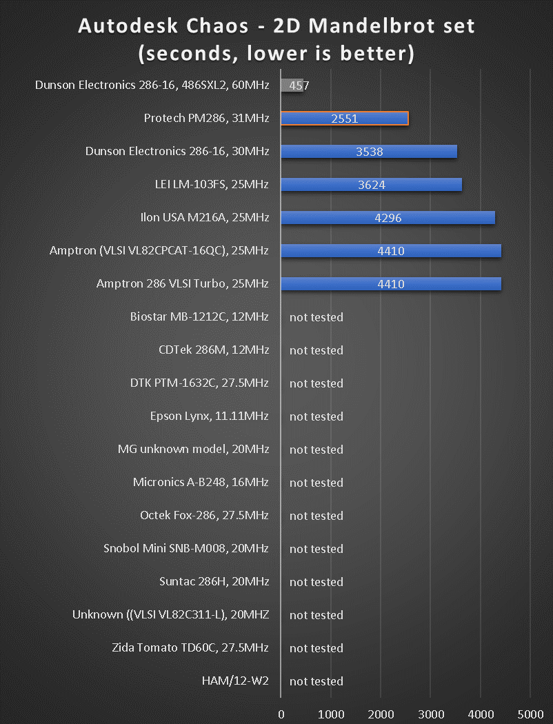

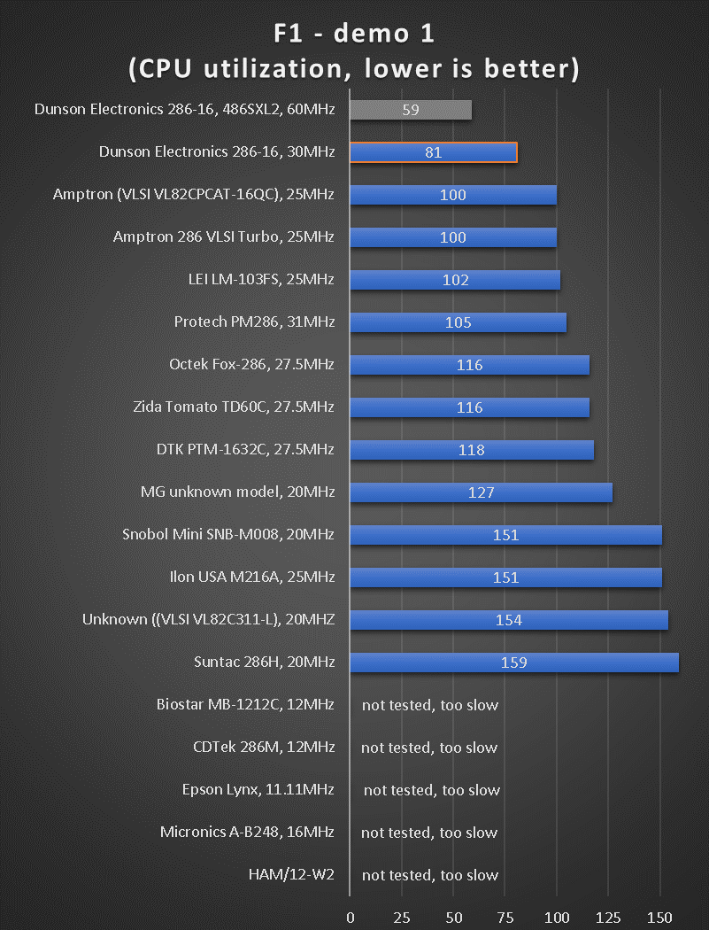

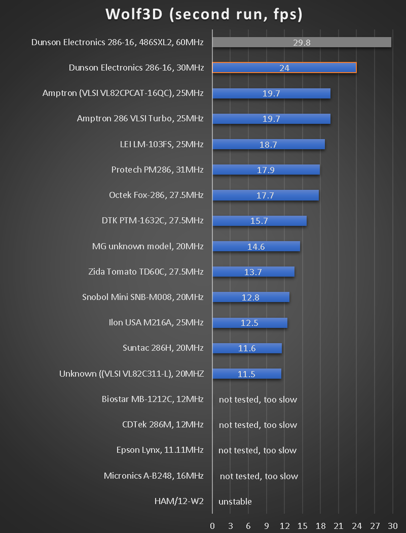

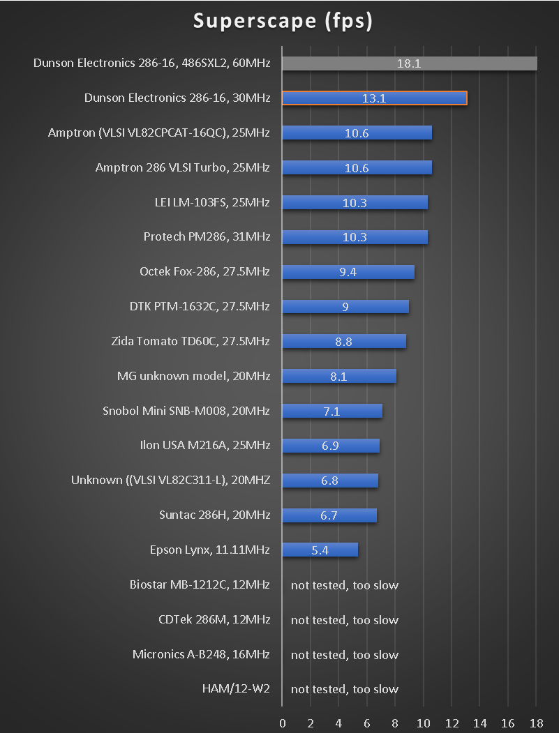

A Continuing with the reorganization of this thread by consolidating all collected performance metrics into single chart with references to it from the individual posts.
286 class motherboards with maximum long-term stable overclock.
The intention was to sample performance and overclocking characteristics of the different 286 chipsets.
Listed boards are some of the best (or only known) implementations built around a given chipset.
Gray bar indicates peak performance achieved with the fastest motherboard/chipset and CPU upgrade with TI 486SXL2 running at 60MHz.
Tseng Labs ET4000AX video card with 1Mb RAM is the fastest graphics adapter for 286 class machines (Cirrus Logic GD-5434 is flaky or does not work at all).
