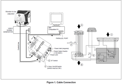

I'm trying to service some LG flatrons I have got my hands on. Recently I've been able to service a trinitron successfully using WinDAS and a cheap usb 232 ttl adapter + dupont cables and winXP (similar to how Adrians digital basement has done it: https://youtu.be/Lt1NtRH4BOg?si=LxI5LPDCiQ4RKeQ5)
Opening up the LG 776FM flatron, i though I would be able to adjust the g2 brightness on the flyback transformer, it's missing. looking at the service guide, it looks like they use the programmable EEPROM thing that sony do. has anyone a calibrated LG crt monitors in the past similar to how sony do theirs?

Reply 1 of 8, by gmaverick2k
Essentially what I'm asking is has anyone serviced one before using cheap off the shelf components like the Sony win DAS solution. I wish this information was accessible in the past as I've had trinitrons that could have been serviced but this time I have four LG flatrons/studio works with no lg specific guides online or on YouTube

Reply 7 of 8, by momaka
I don't know if LG CRT monitors are / may be related to Samsung CRT monitors or not. But if they are, all I can tell you is that I've read in Samsung CRT SM's that they use a software called "SoftJIG". It's essentially the equivalent of what WinDAS is for Trinitrons, but I never used it... and don't think I have a copy either(??) (Will check on that.) I did do some digging into that topic a long time ago, though, since I have a Samsung SyncMaster 955DF that's a little too bright (too much G2), though not terrible like a 21" Trinitron. Was going to mess with it, but then figured I could use the brighter monitor for online gaming, as I already have another 19" CRT that has pretty much perfect colors and brightness which I use for "cinematic effects" gaming.
If there is no software to adjust the G2, you can try to trace back (either in the SM or on the actual monitor PCB) where / to what chip the G2 gives feedback about its voltage value and try to "fool" that chip / circuit with some resistor dividers. Back before the guides for Sony WinDAS became popular online, I remember reading on quite a few places where people used this trick to lower the G2 on their Sony Trinitron CRT.
