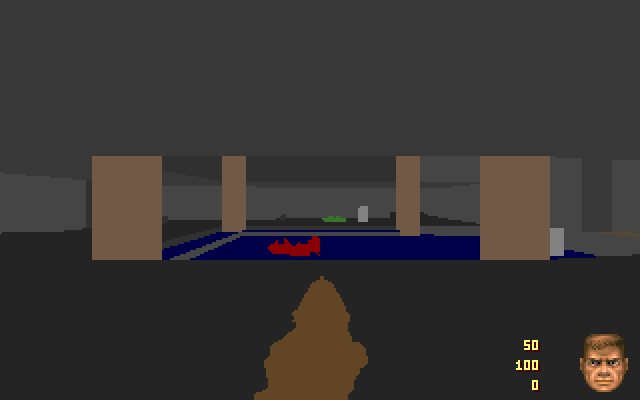

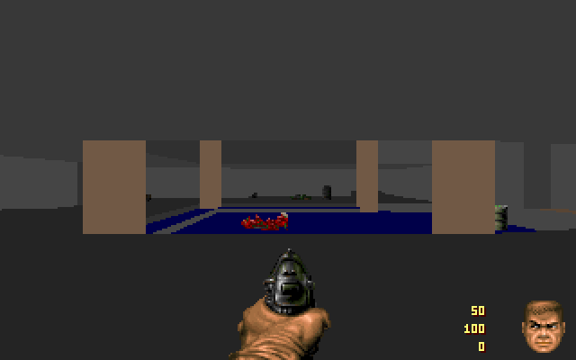

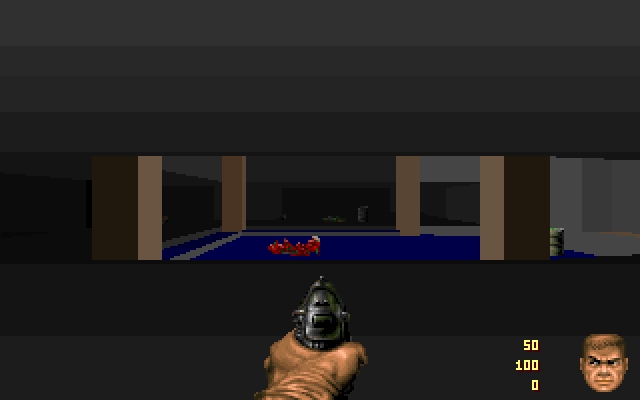

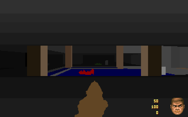

ViTi95 wrote on 2024-07-09, 09:54:
Finally I've added this, it's indeed faster but gameplay gets compromised. Most switches now are not visible, so you have to rem […]
tigrou wrote on 2024-06-22, 10:17:
Is there any plan to disable walls texturing ? (eg: to render "flat walls", just like visplanes).
Same about sprites.
Yes the game would looks like potato, but on a very slow computer that might be a good tradeoff vs playing the game in small viewport.
Finally I've added this, it's indeed faster but gameplay gets compromised. Most switches now are not visible, so you have to remember the maps to be able to play them.
Untextured walls with diminished lightning
4.18 KiB
3970 views
FastDoom flatter sprites rendering
Untextured walls without diminished lightning
4.24 KiB
3970 views
FastDoom flat sprites rendering
As a side effect, also sprites can be draw untextured:
9.33 KiB
3970 views
FastDoom flatter wall rendering
9.4 KiB
3970 views
FastDoom flat wall rendering
This will be available on the next release 😁
Thanks for adding support. It really helps with slow CPUs.
