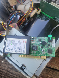

The pci modem

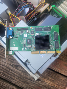

The agp card

The video card is probably a Dell OEM TNT2 M64.
The modem is some OEM Lucent/Agere based 56K winmodem (or possibly even a host signal processing one, Lucent/Agere also made chips for those at some point, AFAICR). Lucent based winmodems ( LT Winmodems) were some of the better winmodems, IMHO.

As long as it isnt a Winmodem then... Its a modem, without more details such as serial numbers its hard to tell from that photo
Reply 9 of 20, by jmarsh
ElectroSoldier wrote on 2024-09-12, 03:47:
As if being a PCI internal modem wasn't enough, it's a Lucent/Agere chipset... practically guaranteed to be a winmodem.
Reply 10 of 20, by rasz_pl
Cursed Derp wrote on 2024-09-11, 20:55:
and this 56k pci modem. Can anyone tell me if this modem is any good?
any good for what? Which ISP do you use>? how far from the colo do you live? 😁

darry wrote on 2024-09-11, 21:13:
Yes, with 32MB VRAM.
Dell part # 073RGY
PCB part # BRD-05-E15 REV C
https://www.ebay.com/itm/295446410492
https://www.lakemichigancomputers.com/product … -agp-video-card
Reply 12 of 20, by dionb
dormcat wrote on 2024-09-12, 17:13:
Looks more like SDRAM to me. Don't think any nVidia-based cards used VRAM other than the nV1 / Diamond Edge3D-3000
Reply 14 of 20, by VivienM
Cursed Derp wrote on 2024-09-13, 00:56:
OK if anyone has the drivers for the graphics card that would be awesome post the link if you have one
Thanks
www.nvidia.com ?
(I'm not trying to be facetious, but it seems to be offering drivers for the TNT2 family to this day... don't think the Dell cards need special drivers)

Reply 19 of 20, by dormcat
dionb wrote on 2024-09-13, 00:06:
I used the term "VRAM" in a less specific manner, as in "video memory." I assume that you meant those dual-ported variant; in that case I have only used one graphics card with dual-ported VRAM (Number Nine 9FX Motion 771) in my life. 😅 IIRC VRAM disappeared after cheaper S3 Trio series (without VRAM support) overwhelmed the market.
