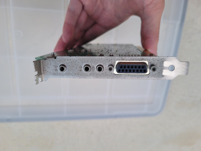

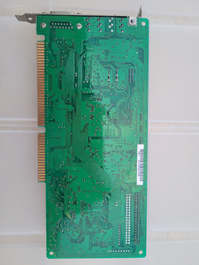

Hello fellow enthusiasts,
I am looking for information on this sound card of mine. Particularly its capabilities.
I can see an OPL chip but but I'm not sure about the rest of it. Looks like an IDE header?

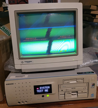

Was pulled from a working Samsung Magic Station III SPC-8260P.
*Image not syncing because 31khz going to a 15khz*

this card uses the OPTI 82C924 chipset that gives adlib/sb/sbpro/wss support and it has a real yamaha opl3
there is also the Dream SAM9203 wavetable synth on it with 1MB rom and ofcourse a CD-ROM interface (probably IDE)
there is a new Opti 924 driver here: Brand New Drivers for OPTI 82C929 and 82C924 including StereoFix , perhaps it will work better than the original one

There's room for two CD-ROM connectors: IDE, and Panasonic proprietary.
Only the latter is soldered in.
Yes, you can use Opti drivers.
For DOS, you can also use UNISOUND.

I stand corrected, like Grzyb mentions the interface is panasonic so not that useful
if everything works as it should then you should have midi in/out via gameport but keep in mind that the onboard dream wavetable will probably play at the same time as external midi

I will definitely test everything to my ability. Waiting on a 31khz monitor to arrive and see if there are any errors in the OS first.
Chances are there will be a Korean version of Win3.1 and or 95, possibly DOS. So I'll have to navigate that 😁
