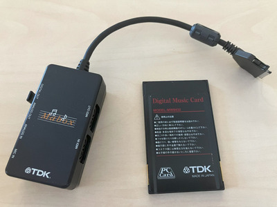

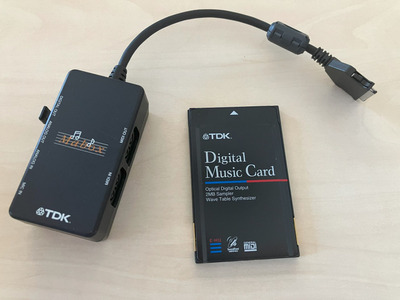

Hello all,
I have a TDK DMC-9000 Digital Music Card.
It has 4MB ROM + 2MB RAM (!!) with a special EMU8000 chipset.
The 2MB RAM can be used for uploading additional user soundfonts!
Also it's breakout dongle, the Mabox, has MIDI In-Out, Mic In, Analog In-Out and even a Digital out!
It's instruments are similarly sounding to the Roland SCP-55, but even better I think, because they sound more pronounced and cleaner.
If anyone is interested in details, test sounds or anymore testing or ideas, contact me in private!
The attachment img_3936.jpg is no longer available
The attachment img_3939.jpg is no longer available

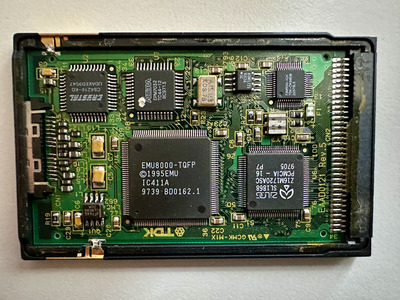

Reply 645 of 754, by zikolas
The glue on the lid of my DMc9000 failed and it fell off, so here’s a pic.
The attachment IMG_7165.jpeg is no longer available
Reply 646 of 754, by Kahenraz
Were there any metal tabs on the lid or was it just glue keeping it down?
Reply 647 of 754, by zikolas
Kahenraz wrote on 2024-12-13, 13:14:
Just glue, top just fell off when I took it out of the box.

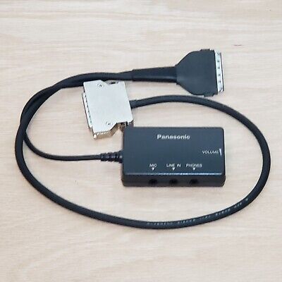

Reply 652 of 754, by Bondi
Kahenraz wrote on 2024-12-16, 01:41:
MAZter wrote on 2024-12-16, 01:33:
Panasonic KXL-D20 on eBay, if anyone wants for collection, I think $100 is too expensive and seller rate not perfect. Box picture only from one side, looking to seller reviews my opinion item is not new as described.
https://www.ebay.com/itm/167173362369
Doesn't this card require the matching CD drive to function?
No, it works without the CD unit. It comes with this dongle with a breakout box and a separate SCSI cable. Connecting the SCSI device is optional, sound still works.
The attachment s-l400.jpg is no longer available

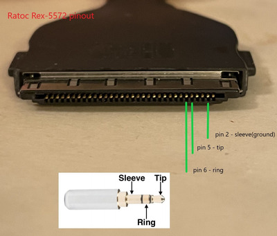

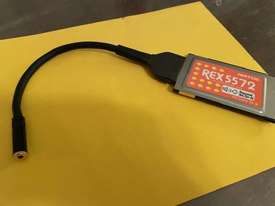

I had this loose Ratoc card lying around, so I made a dongle for it of a spare cable for an IDE card I had. It's a Hirose 32 pin connector. In the original breakout box there are no passive or active components on the line out trace, so it's very straightforward to make.
The attachment 5572 pinout.jpg is no longer available
The attachment IMG_2418.jpg is no longer available
