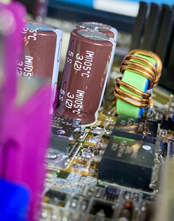

momaka wrote on 2024-11-13, 22:06:
Socket A builds are probably the most tricky of all, especially the part with the cooling/heatsink.
I'm so sorry I missed your great and detailed reply! Reading now...
Are you 100% positive that when you installed the 2nd CPU with its heatsink that it was making proper contact with the CPU core/die?
Actually no, I mean I just put heatsink on top of it but i didn't clip it tight for making a good contact with DIE. It was just sitting freely on it, spinning a fan. I couldn't even imagine couple seconds is enough for killing a CPU ...
This is very very very .... (very) embarassing, really. I was being an utter idiot !
As many as it takes? For science. You monster! 😉
Yeah and as I have just figured out a stupid one 😀
At least try going with some less-rare CPUs, so you don't piss off the collectors. 🤣
good point.

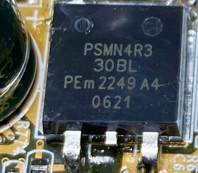

BTW, I looked at the pictures on TRW, and this motherboard appears to use a synchronous buck VRM for the CPU, meaning it *should* be pretty hard for the board to fry the CPU, even if there was a shorted MOSFET (which I don't think is the case here... yet?) In any case, just to (roughly) rule out any high-side MOSFETs being bad, check resistance to ground on all of the pins in the 4-pin 12V CPU power connector. Two of those pins will be ground and should show a short circuit, but the other two are for the 12V rail and should show a relatively high resistance (KOhms range, at least.) Do this test with the PSU disconnected.
I replaced all MOSFETS and made sure their high side is getting 12V on a drain and made sure the low sides don't get 12v on a drain. Also I "oscilloscoped" both high and low sides to make sure the working cycle looks good.
So it's really is me who thought just placing a heatsink on top of Athlon is enough. Also this motherboard doesn't have any protection from idiots which played it's role.
I've got ABIT mobo which works just fine and I also didn't clip heatsink but in this case mobo is turning off, so the temp diod is there on the board saved me another Athlon.

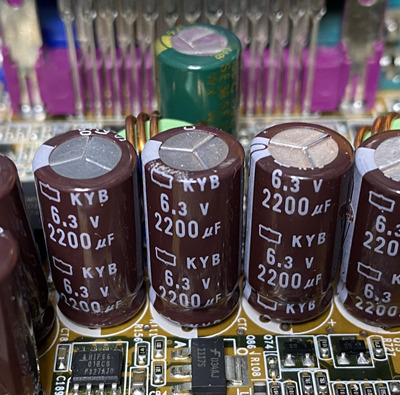

Reply 34 of 49, by mockingbird
Ujeen wrote on 2024-11-22, 02:09:
I replaced both capacitors and MOSFETS after I'd burned my first CPU
then I successfully fried the second one with whole new VRM soldered in 😀
Which capacitors did you use?
KYB caps and contemporary MOSFETs (looks like proper substitutes)
    54.44 KiB
    492 views
    KYB caps
    295.42 KiB
    492 views
    KYB caps
    455.61 KiB
    492 views
    MOSFET (substitutes)

Ujeen wrote on 2024-11-22, 01:28:
thats impressive dedication for a lowend nforce2 (they all die, chip is factory defective) board 😮
