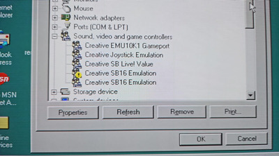

If the installation was successful, you should now have the following under Device Manager:

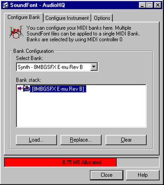

6.1 Go to the D:\DOSDRV\SF2 folder and copy all the .SF2 files from there to C:\WINDOWS\SYSTEM
6.2 Go to the D:\DOSDRV\ECW folder and copy all the .ECW files from there to C:\WINDOWS\SYSTEM
6.3 Start > Programs > Creative > Creative AudioHQ > SoundFont
6.4 Click on "Configure Bank" then click on the default soundfont (2GMGSMT Rev N++) to select it, then click Replace, select C:\WINDOWS\SYSTEM\CT8MGM.SF2 wait a few seconds until it loads then click Ok > Close
6.5 Open C:\WINDOWS\CTSYN.INI in Notepad and change this line: Waveset=C:\WINDOWS\SYSTEM\default.ecw to this: Waveset=C:\WINDOWS\SYSTEM\EAPCI8M.ECW
6.6 Save the changes you just made to CTSYN.INI then restart your computer
6.7 Run your favorite DOS game and in setup choose General MIDI for music

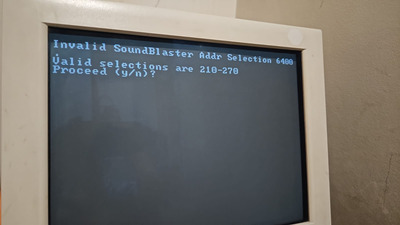

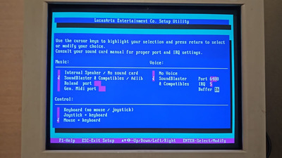

Hi...greetings joseph, i'm trying to install my first retro pc to play some sierra and lucas arts game.
i have P1 166 Mhz , 80 ram , Chipset: VIA Apollo VPX, WIn96SE
Sb Live Ct4760 + Front panel
i'm completely newbie with all the settings, but gladly found your tutorial
Tried to follow your instructions and all drivers already installed
Creative audio @port 6400 irq 5
Try to play Fate of Atlantis from pure dos there was no sound at all
Did i do something wrong?
Please advise....thank you
Reply 217 of 242, by Joseph_Joestar
yukboboyuk wrote on 2024-12-04, 16:56:
Hi...greetings joseph, i'm trying to install my first retro pc to play some sierra and lucas arts game. i have P1 166 Mhz , 80 r […]
Based on that screenshot, you have two SB16 emulation entries in Device Manager. This shouldn't be the case with SBLive cards, so I'm guessing something went wrong during the installation process. Also, the port you selected in the Fate of Atlantis setup is incorrect. It should be 220, not 6400. The latter is the internal address which is used by the card itself, and isn't meant for games.
Other than that, it's possible that Fate of Atlantis is simply too old for the SBLive. For DOS games from the early 90s, it's best to use an ISA sound card.
