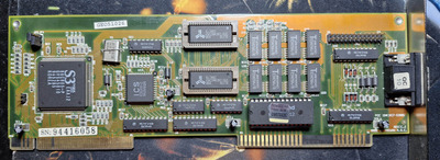

Hi,
i need help from geniuses here!!
I have one VLB card i bought few days ago that has some weird problem. Cards works ok until it starts to load DOS. Than the picture starts to blink (maybe every second or two). I tried to enter Prince of Persia, and i played game for almost 15 minutes, and it has blinked maybe every minute or so, but no freezing or artefacts?!? It is AMD DX4-120MHz computer with 16MB FPM RAM, and Abit AB-PW4 board. Other VLB card (Cirrus GD5428) works fine.
What could be the problem? I have changed 4 small 10uf capacitors, but the problem remained. Could it be some logic chip or memory, or even oscillator?
Thanks in advance

Reply 1 of 11, by Horun
My guess: incompatible video ram is creating the issue. The main/soldered ram chips are TC514256AJ-70 standard DRAM but those ram upgrade chips AS4C256K16E0-50JC are EDO.
Try this: remove the upgrade chips and see if you still have an issue. If you do still have the issue it is something else, use a pink end of pencil eraser and gently erase clean the contacts, then use some 99% IPA and wipe them clean again.
Then try again (without the EDO ram installed)....am fairly sure EDO was not supported until the S3 Trio chipsets iirc and yours is a 805....and mixing types is always bad

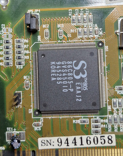

Reply 5 of 11, by Unknown_K
Your picture is blurry but the main S3 chip has 2 lines soldered together (could be that way from the factory), and also it looks like top right corner (second down) has a broken lead touching the one below it.
Reply 6 of 11, by butjer1010
Unknown_K wrote on 2024-12-08, 12:15:
I think those are ok, hope this picture is better? Those two connected are "factory connected" 😀

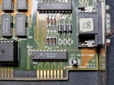

Reply 7 of 11, by butjer1010
One thing i could do now is to reflow all the solder joints, maybe a little bit of hot air with flux on main memory chips.... But if someone has better idea, please help 😀
