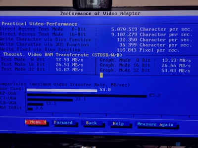

Don't you need 2 MB to do 1024x768x65k ? or is that only with interlaced mode? I normally run 1024x768x65k in Win3.1 on ISA 486 systems.
Reply 267 of 372, by kixs
2MB has no use in DOS. But it's a must for Windows. One is more resolution choice, the other is speed improvement.
Visit my AmiBay items for sale (updated: 2026-03-23). I also take requests 😉
Reply 268 of 372, by rasz_pl
Second megabyte on CL-GD5426/'28/'29 unlocks 256 colors in 1280 x 1024 (interlaced), nothing else.
In CL-GD5434 2MB not only unlocks maybe useful 32K 1024 X 768@75, 256 1280 x 1024@75, 16M 800 x 600@60 but also doubles data bus width probably also making blitter faster.

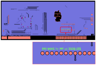

Reply 275 of 372, by zami555
Hi Madao. I just wanted to order the PCB for S3 Trio64V+ VLB. I'm using gerbers, which are on your github. Unfortunately I've found some issue with Silk Screen on Bottom. It seems the text, which suppose to be placed on Top under the Video BIOS chip, is loated on Bottom and is mixed with the other text. Is there any chance to have this updated? I would like to avoid modifying your work by deleting this portion of gerbers, especially that this text is with your signature!
Reply 276 of 372, by Madao
zami555 wrote on 2025-03-11, 19:45:
Cleaned gerber file is uploaded.
I haven't regonizied this typo, because chinese pcb manufactur has removed one of both string.
Thanks

Reply 278 of 372, by zami555
Madao wrote on 2025-03-11, 20:08:
Wow, that was pretty fast, thank you very much 😀 I've double checked it and looks good now.
