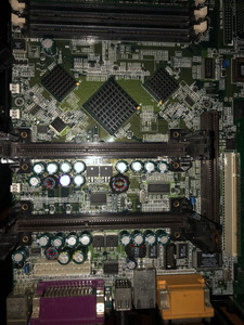

It is also possible that the board has damages and/or drained capacitors around the cpu slots, but I cannot see anything.
Here attached if you want to take a look.
Reply 66 of 74, by tauro
You're only going to find out if you remove them and measure them...
Have you tried any Radeon cards?

Reply 68 of 74, by tauro
If it's not a hardware thing, then it's likely to be a BIOS limitation.
I read you tried Nvidia cards and they didn't work, so I thought maybe an AGP Radeon card could be compatible.
I remember having problems with AGP cards on a 440EX chipset. Some worked, other didn't. I distinctly remember that a Voodoo 3 indeed worked.

Reply 71 of 74, by Mamba
Tested again the voodoo 3000. Rock solid
The same for a Rage pro 8mb I had.
Radeon 9500 is a no go.
It seems that anything not 3.3v won’t work (D3-14).
