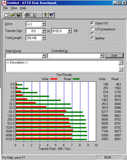

GLQuake at 512x384 does not run smooth, not perse low fps but many hickups.
Duke Nukem 3D at 640x480 stutters and hangs when starting up but once in game runs fine.
Grand Theft Auto in glide mode has some delayed control issues and in 24 bit mode it also stutters.
Outlaws seems to run fine.
I've read somewhere that it could be the polling of USB devices (both keyboard and mouse are usb) which slows things down.
Could it be a a bios setting? Or am i expecting too much from this machine?

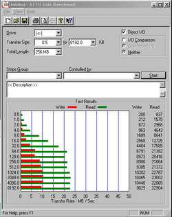

Thanks for your responses. To answer the questions:
It's a Lucky Star 5mvp3 rev 2.1 motherboard (theretroweb link)
For storage i use an IDE to compact flash adapter which reaches around 60 MB/s read speeds under windows 11.
In general the PC is very stable, everything just works. 3DFX, LAN, USB, MIDI.
It just feels like something is bottlenecking and causing stutters.
I will run the benchmark suit!
Also there is a lot to setup in the bios about ram timings (which are now set to normal), AGP Aperture size, AGP writeback, etc.
