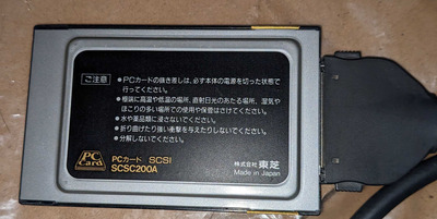

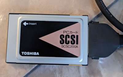

Does someone know where I can download driver for this Toshiba PC Card SCSI (SCSC200A) PCMCIA Adapter?

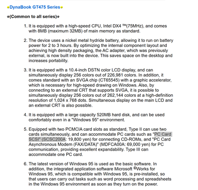

Possibly it only works in DOS or Windows 95:
https://www.global.toshiba/jp/news/corporate/ … 901/doc_04.html
Thanks!

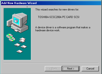

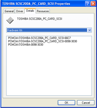

Here're the screenshots from Windows 9x auto-detect and XP device manager

Thanks! I found a Qlogic driver from Internet Archive, I will try that: https://archive.org/details/QL1000_EXE
Reply 5 of 6, by sangokushi
I need help in editing the inf file. Below is the inf for QLogic Fast!SCSI.
How can I convert this "PCMCIA\TOSHIBA-SCSA200A_PC_CARD_SCSI-66C7" to the format in "; QLogic-manufacturer device list" section?
