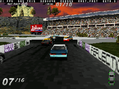

The first post has been updated with beta.3.
This version adds a 320 x 240 render mode (upscaled to 640 x 480 for display), centers the 512 x 384 letterboxed mode, and fixes an occasional frame hickup. The in-game UI scaling at 320 x 240 isn't too great, but not impossibly bad.
In 86Box, the 320 x 240 mode is just about playable on a Pentium MMX 200:
The attachment uhyr2te.gif is no longer available
So within the space of a week the minimum playable requirements went from a Pentium 4 to a Pentium 1.

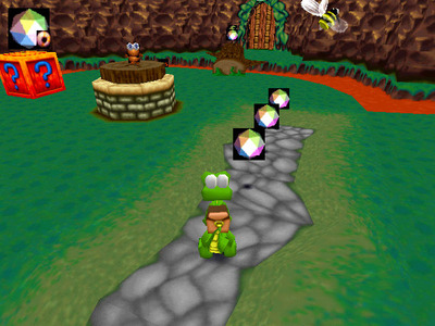

Reply 64 of 155, by vvbee
The less well they work the better for this DD optimized version. Croc doesn't use DirectDraw for S3d so it wouldn't be supported by this anyway. The intro is something else. The game uses VRAM directly like DOS S3d does so you'd need to implement some device independent way to display the output while still directing input to the game etc. Maybe there's a way and maybe not, as pointless as it is.

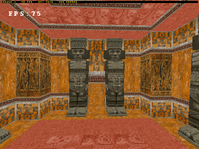

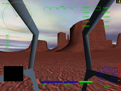

First post updated with v.3.
Adds a FRAPS-like FPS overlay wrapper for Win32 S3d, requires an S3d card. The tracer will now pass S3d render calls to the driver if there's an S3d card present, so you don't have to look at a blank screen.
The attachment dftbjth.gif is no longer available
For some games the FPS overlay works alright. For MechWarror 2 it's so so, maybe you'll get some useful readings here and there. Different games use different methods. Like FRAPS it has an effect on performance, but I haven't looked into it.

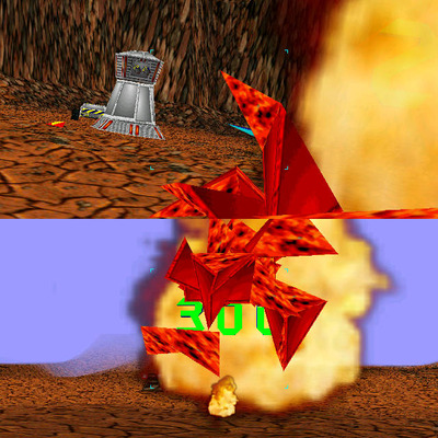

Updated with v.4.
Added a software wrapper for Havoc. Supports bilinear texture filtering but not mipmaps. Requires a CPU with SSE, but probably Pentium 4++, haven't tested it much.
The attachment 6y5rjk9.jpg is no longer available
FPSCounter is less conservative about redrawing itself. Will result in the counter flickering more in some games, e.g. Croc. See workarounds in the INI. Now works in Havoc.

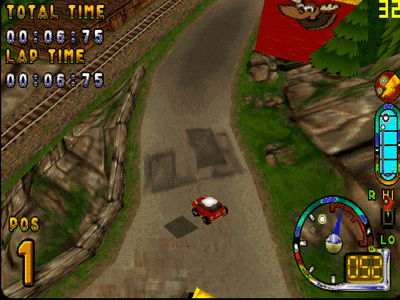

Reply 74 of 155, by vvbee
Updated with v.5.
Added a software wrapper for POD. Far as anyone knows, this game uses S3d only for shadows, skidmarks and smoke, the rest is CPU. That makes this a unique version of the game, software renderer with true alpha blending.
Fixed some missing alpha blending in Havoc. Based on my real world testing, you'll want an Athlon 64 ~3 GHz or equivalent for decent FPS.
The FPS counter was improved for MechWarrior 2. I verified using my capture software that the FPS value is accurate, at least for the 30 seconds of gameplay.
