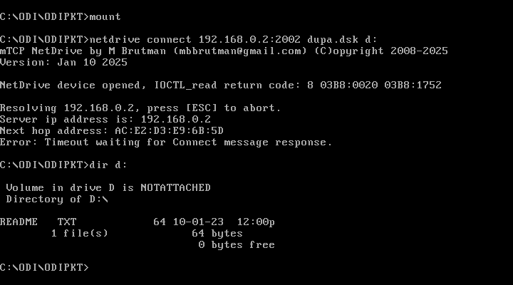

Reply 245 of 383, by Grzyb
mbbrutman wrote on 2025-02-11, 22:41:
One more time please ... just download that file again. (I replaced it.)
This time it fails on "netdrive connect...", but doesn't hang.
Tried with both ODIPKT and PKT2ODI - same effect:
The attachment odipkt.png is no longer available
[/s]
In 2003, I voted in favour of joining the European Union. However, due to recent developments - especially the restrictions on cash usage - I'm hereby withdrawing my support. DOWN WITH THE EU!
Reply 246 of 383, by mbbrutman
You might want to clear things out and try again ... I didn't change the "connect" flow, and you are using the same EXE as before so that should have worked. If it connected before, it should connect again.
And just a technical note: the reason you were able to see the directory listing before is because after the connect the EXE program does a filesystem command to force DOS to see the disk change. The root directory was probably buffered by DOS at that point. Further attempts to do reads would be failing once the SYS is given control, probably due to something mismatched in the ODI conversion.
