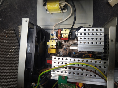

While messing around with this one I noticed that after the voltage drops around .30v there's an weird funny smell inside (not the one before!). If I go over the 5VSB arena I can feel with my face the heat dissipation from that spot.
My idea is, before poking inside with my finger when the caps go bellow 50VDC, to desolder the 5VSB transformator and see if the heat dissipation (more like heat radiation(it's that powerful)) is still present.
EDIT: I have applied power to the PSU without the 5VSB transformator and there's no funny smells and no heat dissipation from that arena after around 1-2 minutes, so fairly confident the transformator is at fault.

I have soldered in the EEL-19-2005 transistor and the EE-19-2005 one using wires and double checking the pinouts and I still get absolutely nothing on the 5vsb rail and sec. aux. rail.
I have no idea what is wrong here...

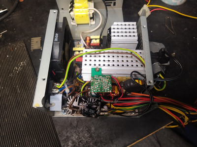

Since it looks like I am nowhere near repairing the 5VSB circuit I decided to go with an 10V psu for sec aux rail and an 5V regulator using TL431 from the datasheet using an BD135 as the NPN transistor and potentiometers for the resistors.
Sadly I get 1.71V on the output.... I have double checked the connections, all go where they should. What's weird is when I touch all the pins on the transistor with my finger the voltage spikes up to 5.35v!
Any ideas?
Scratch that, I forgot I could use an 5V VRM module.
With an hahn 230-10v transformator, bridge rectifier (with it's filter cap) and an 7805 VRM I now get both 10VDC and 5VDC. The next step would be to solder it temporarily inside the PSU just to test. And if everything will work I'll make room in the 5VSB arena to fit the new PSU.

Okay I have found an 1A toroid that generates 11.5V on output and made an 5V regulator for 5VSB and 10V regulator for sec aux rail using the 7805's.
After putting everything together (including bridge rectifier) I can now power the PSU on no problem. Sure, there's an toroid case sticking out of the back but who cares, the PSU lives!
Before I summarize the repair I'll have to try it without dim bulb and toaster protection. Right now the voltages are stable with 4 3.5" HDD's, 2 fans and an nf610 board (without CPU power).
Everything seems to be working so far, so this is another PSU saved from the trash 😀
