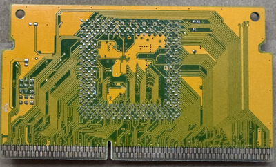

Can you post a photo of your slotket ? It is possibly not supporting FCPGA cpu's.

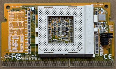

The slotket supports Coppermine and I have an 850MHz in there clocked at 1130Mhz with 133FSB.

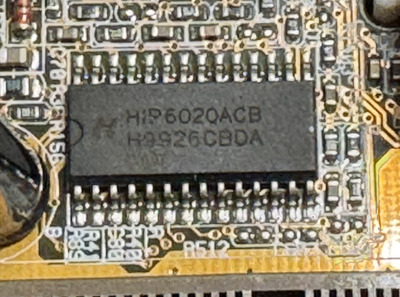

Here are the pics of the slotket and the voltage regulator.

The HIP6020ACB supports voltages down to 1.3V.
Also, I have the same P3B-F v 1.03 motherboard and it works fine with modified Tualatin CPUs (manually modified, I never used the Korean guy's adapters) on MSI 6905 ver 2 / ver 2.3 slotkets. Since you have a generic slotket, your mileage may vary.

That sounds promising. You could try to set the FSB jumpers on the slotket to AUTO and maybe increase the voltage on the motherboard a bit.

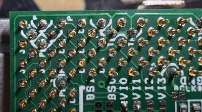

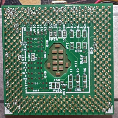

Maybe I made a mistake with the soldering of the adapter.
Does anyone have experience with that?
I’m not sure the reset pin AJ3 is making connection because the pin was removed prior to soldering the adapter and I had to fill the hole afterwards.
Would the processor POST without connection?
Should I remove the VID2 pin?

Man, that so called "easy adapter" is much more complicated than simply modding the thing manually. Don't know why you guys bother with it.
byte_76, I have to say, those solder joints don't look too good. So it's very hard to say if the connections are good or not.

I tested the solder connections with my multimeter and they’re all making connection.
I think the lower quality image makes the solder look bad but the solder joints aren’t bad.
I’m more concerned about the connection to the VttPWRGD (CPU side,AK4) pin and whether VID2 should be removed or not.

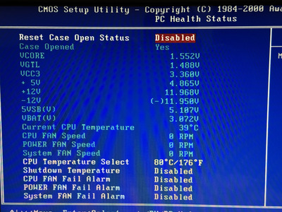

There is something strange.
It reports 1.552V for vcore.

Reply 16 of 30, by PARKE
That may mean that the korean adapter is modded to signal for 1.55volt. My suggestion is to follow riplin's earlier suggestion and set the slotket to AUTO and set the P3BF to JUMPERLESS via the JEN jumper. If that does not work then there may be something unhealty going on with the slotket or with the power delivery of the P3BF.
That slotket, btw, is a knock off of the "Super Slocket-III" wich on its turn was derived from the Maxtium CPU370 ver. 1.0.

Reply 17 of 30, by bloodem
PARKE wrote on 2025-03-25, 10:54:
According to his documentation, depending on which pin you connect to ground, it should be either 1.45 or 1.5V.

Reply 19 of 30, by bloodem
PARKE wrote on 2025-03-25, 11:28:
Maybe the voltage reporting of the Gigabyte board is off ?

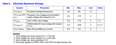

Could be... Either way, even if @byte_76 made a mistake when soldering and it's indeed running at 1.55V, it's totally fine.
Per Intel's datasheet:
