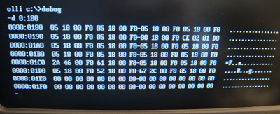

Reply 288 of 329, by vetz
Trying to get the NetDrive packetdriver shim to work, but whatever I do I get the following error message when running DHCP:
"Init: Could not setup packet driver, are the configured interrupts correct? Configured packet driver interrupt: 0x%X"
What am I doing wrong?
System: Olivetti M28 286 /w 1mb of RAM
DOS version 3.10 (but I've also tested with PC-DOS 6.1)
Packetdriver: 3C503.COM 0x60 3 0x280
MTCP.CFG:
PACKETINT 0x60, 0x65
MTU 1500
Packetdriver loads as normal
Then I start DHCP and get the message above. It does read "NetDrive packet driver shim installed at 0x65" (message might be slightly different as I'm doing from memory).
Everything works fine when I only have PACKETINT 0x60 in MTCP.CFG (except that other mTCP programs do not run with Netdrive)

On the same machine (Olivetti M28 286) reboot and before you do anything, run debug.com so I can see the contents of the memory:
debug
-d 0:180
0000:0180 00 00 00 00 ...
0000:0190 00 00 00 00 ...
If you can get a picture of the contents that will confirm a theory I have. Assuming you are using PACKETINT 0X60, 0x65 then just the first two lines are all I need.
Thanks,
Mike
Reply 292 of 329, by vetz
Here is the command after startup. Netdrive.sys have loaded, but not the ethernet packet driver, nor DHCP.
927.06 KiB
538 views
Reply 293 of 329, by mbbrutman
Ok, that's the problem. Unused software interrupts are normally set to 0, while on your machine they are set to F000:1805. The NetDrive code is very careful to check the secondary software interrupt to ensure that it's not stepping on anything, and that it's also not in use.
You can get around this by zero'ing out the specific bytes for software interrupt 0x65. To do that use debug again:
debug
e 0000:0194
00
00
00
00
<press enter to stop>
That sequence is from memory so it might not be exact, but the goal is to get the four bytes at 0000:0194 to zero before you start anything else.
Your packet driver must be installing itself at 0x60 (memory 0000:0180) without checking to see if something is there first, which is why it doesn't complain. I'm not that bold yet.

Reply 296 of 329, by vetz
mbbrutman wrote on 2025-03-31, 17:39:
Ok, that's the problem. Unused software interrupts are normally set to 0, while on your machine they are set to F000:1805. The […]
debug
e 0000:0194
00
00
00
00
That actually worked. I cleared out 0194, 0195, 0196, 0197 and 0198 and then ran DHCP.
I also checked this on my 386 where it worked out of the box. Debug there showed all 00 for 0180 to 019f range.
So is this something you can fix in a future version, or should I look around to either figure out what is filling this memory section or include in autoexec.bat some way to clear these bytes?
Reply 297 of 329, by mbbrutman
Usually the BIOS of the machine sets those values. Zeros are the normal "this is not in use" value. Sometimes a BIOS will get clever and put a pointer to an "IRET" instruction there instead, so if somebody tries to make a call to an uninitialized software interrupt the call will not crash the machine. Except there is no standard value for where that IRET instruction should be ...
I'm not going to fix this in mTCP because I'd have to keep adding special cases for all of the different BIOSes that do this. I added code for the PCjr, as there are a lot of them and it's my favorite machine.
Before somebody says "You could look at the address and see what is there before deciding whether it is used or not" it's not always a single IRET instruction. It just gets too complicated.
My suggested solution: Create a small text file with what you typed into DEBUG to clear those bytes out, then run DEBUG.COM with input from that script file after you run your packet driver.
