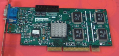

Reply 24 of 51, by vvbee

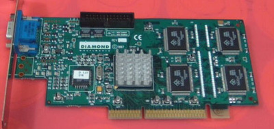

Eighth subject: Diamond Fire GL 1000 Pro (Permedia 2). About ten wet SMD alus, 10 uF 16 V. Measured two of them after twisting off the board, capacitance was ok and ESR about 12. Slightly crusty on the bottom. Don't know what voltages they see in use, probably 5 or less. There's also one tantalum, might've been 4.7 uF 16 V.
30.14 KiB
684 views
The wet caps were replaced with 10 uF 20 V tantalums.
30.12 KiB
684 views
Card works. 2D image quality was slightly ghosting before and unchanged now. Still good quality, just not absolutely perfect.

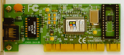

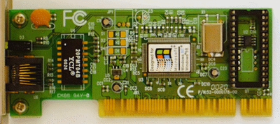

Reply 25 of 51, by vvbee
Ninth subject: Edimax EN-9130 (Realtek RTL8139) network adapter, from 2000. Three wet through-hole alus, 22 uF 16 V. Capacitance measured ok, ESR in the 5-12 range. One had 5 volts across it, the rest I didn't measure but I don't see them getting 12 volts.
92.07 KiB
652 views
Replaced with 22 uF 16 V SMD tantalums. Would've preferred through-holes but these will do.
88.23 KiB
652 views
Works, i.e. the driver installs and the lights come on.
Voltages measured after the fact: 5, 5, and 3.

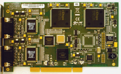

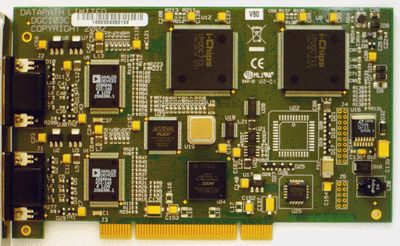

Tenth subject: Datapath VisionRGB-PRO2 capture card, from the 2000s. Lots of tantalums but also four wet SMD cans, 2 22 uF 6 V and 2 47 uF 16 V. The bigger ones have 5 volts across them and 3 for the smaller ones, at least when idling. Capacitance was ok, ESR 3 for the bigger ones and 11 for the smaller. No signs of leakage.
114.58 KiB
590 views
Replaced with 22 uF 16 V and 47 uF 16 V SMD tantalums.
118.67 KiB
590 views
Maybe works and maybe not, don't have a supported system on hand to test. The PCI device and vendor ids look ok anyway.

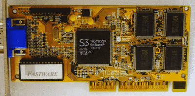

Reply 34 of 51, by vvbee

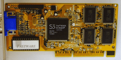

11th subject: S3 Trio 3D/2X. Three wet through-holes, 47 uF 16 V. Capacitance about 53, ESR 1.4. None had more than five volts across.
58.31 KiB
421 views
Replaced with 47 uF 16 V through-hole tantalums.
59.24 KiB
421 views
Works.

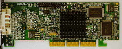

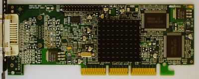

12th subject: Matrox G450, LP version. About a dozen surface-mount wet alus, 10 uF 16 V. Measured one of them, capacitance ok and ESR 11. No obvious signs of leakage, so a good time to get rid of them. A few tantalums on there as well, 10 V or less. I know on the G550 no capacitor has more than five volts across it, so let's assume that's the case here.
69.82 KiB
273 views
The wet alus were replaced with 10 uF 20 V surface-mount tantalums.
71.59 KiB
273 views
Works, although I forgot to replace one of the removed wet alus.

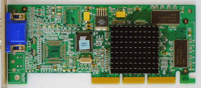

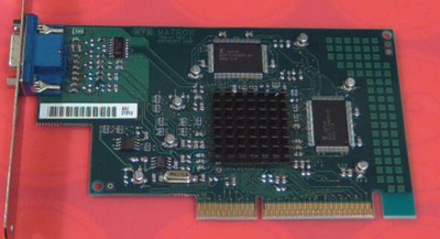

Reply 39 of 51, by vvbee

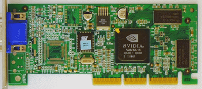

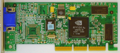

13th subject: Nvidia Vanta-16. Two wet surface-mount alus: 470 uF 6 V and 330 uF 6 V. Measured ok, ESR in the 0.2 range. Didn't bother measuring voltage across them.
88.01 KiB
236 views
Replaced with 10 V surface-mount tantalums of the same capacitance. The pads are on the thin side for these. There's also pads for through-hole capacitors.
87.85 KiB
236 views
Works. Needs a heatsink.
