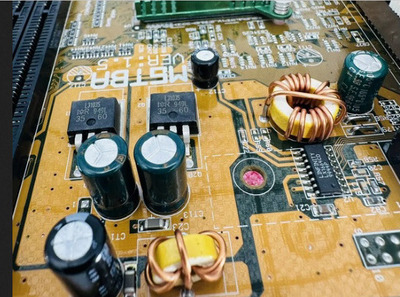

Well I think there is still a chance that the LX1664CD is able to go down to 1.3 volt because it supports 1.8 volt and that falls in the same category via VID4 = 0. There is a motherboard on Ebay under the title [ Vintage Merit System Mainboard Intel BX Pentium III M6TBA ] wich is a version 1.5 and according to the photos of the box it supports coppermine and it has an LX1664CD installed - see photo

PARKE wrote on 2025-04-13, 13:18:
The attachment Merit1s.jpg is no longer available

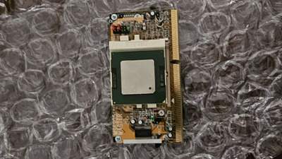

Okay, so the slotket arrived and the CPU will arrive soon, I am having trouble removing the OLD Pentium 3 Slot 1 CPU, the online tutorials don't seem to help because I am not seeing retention clips or levels on the side pillars.
Let me know if you have any suggestions.
Reply 29 of 52, by Matt The Cat
I thought I attached an image to the last post but it didn't show. Here it is. The Slot 1 P3
Reply 30 of 52, by Matt The Cat
Matt The Cat wrote on 2025-05-13, 23:11:
I got it out by unscrewing all four screws of the side pillars and removed them, but this isn't the typical means is it?

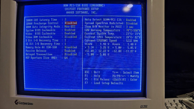

Reply 36 of 52, by Matt The Cat
Here is another picture. It seems to show the CPU running at essentially a proper voltage and a reasonable temperature?
Reply 37 of 52, by Matt The Cat
At this point I've thrown in the towel. I tried changing the jumpers to manual and testing different things. I removed and redid the thermal paste and made extra sure to loosening without overly so doing it with the heatsync as the modded Tualatin Celeron seller recommends. I doubley made sure that it was fully seated all the way, but it just doesn't work. There is a cool down, but I don't know exactly what it is. I went back to the pentium III 450MHz for now, and it works as it did before. Hopefully something good will come out of this situation in the future. Thank you for all of your support.
Reply 38 of 52, by PARKE
There is one aspect that could be causing problems with this sort of set up. The high-end Coppermines and Tualatins may draw more power (in amps) than what the 8.4 vrm of the motherboard can handle. You can read about it in the second part of this article:
http://www.duhvoodooman.com/powrleap/LFL/Slot-T_1.htm
Reply 39 of 52, by bloodem
PARKE wrote on 2025-05-20, 08:13:
I confirm, I had the same issue with an Amptron PII-3100 board which refused to work with power hungry Katmai or Coppermine CPUs.
After I replaced the CEB603AL MOSFETs with CEB703AL, the board now works perfectly with any CPU I throw at it, including a P3 Coppermine 1 GHz or a Tualatin 1.4 GHz. So I'm 99.9999% sure that this is also OP's problem.
