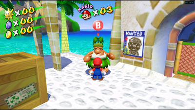

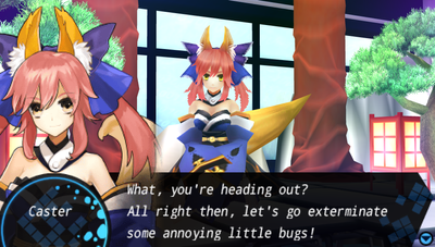

Before:
1.15 MiB
2159 views
After:
1.6 MiB
2159 views
