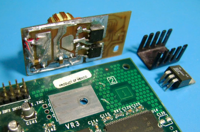

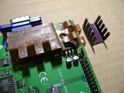

I was thinking maybe just a decently powerful 40mm fan screwed to the heatsink, but then there's the issue with the linear regulator burning hotter than the sun. Other than bypassing it with +3.3V from the motherboard, is there any way to tame this down? I know it could probably benefit from some thermal compound in-between the heatsink and the regulator, but I also don't know if that's enough. And I think that the other regulator/transistor without a heatsink screwed to it might benefit with some cooling, but would a heatsink even help when it's only on the epoxy/plastic side? My Voodoo3 AGP seems to do fine with just the fan obviously. I just want to tame the temperatures on this thing because even with a large case fan blowing on it, it's still running pretty hot, and it's seen pretty low usage over its lifetime so I'd best catch it early.

You can buy small square copper heatsinks for pennies that come with thermal tape on them that you can then stick to the regulator and ram chips, with the fan blowing on the card itll cool that regulator down pretty good.
I bought two dozen of them a year or so ago from China for about 5 bucks, pretty much perfect for small ICs. (Yes they are actually copper and not adonized Ally)

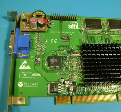

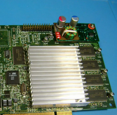

Replacing the linear regulator with a PWM regulator completely solves this problem. Similar to how it is done on all Voodoo4. I made myself one of these and am completely happy.

Yeah, I was thinking maybe a buck converter that could be screwed to the top corner of the card and soldered in place of the linear regulator. Trying to cool it seems like a lost cause. Does the V3 PCI use all 4.6A from the EZ1585CT? Looking at a couple right now that are rated for 5A, but I'm not sure if I need to even go that far. Some general calculations tell me it would be 3-4 amps.

I saw your post on an older thread swapping the EZ1585 with APW7120+2SK3918. After doing some research (and using my brain a bit) I've decided the card is too valuable to be risking some cheap switching voltage regulator.. Probably going to use a third party to print out the PCB with the Sprint file you posted before, but do you recall what parts you used exactly? Thanks!

I took the linear VRM off my V3 2000 PCI and tried just feeding it from a wire spliced directly to the 3.3V line of the ATX PSU. I was expecting some voltage ripple to cause artifacts or instability, but it's been working perfectly like this for the past two years. With a 40mm fan on the main heatsink, it runs nice and cool in my compact Mini-ITX build.

I was wondering why I couldn't just do that, but I also heard that it's not the best idea. Not sure why, when like Postman said that's exactly how the AGP variants did it. I ended up going the PWM route to be safe.

I would feel better trying it out on a less-desired PCI card first, but if yours is already getting the brown discoloration, I'd say go for it. I went the DIY route and I'm getting amazing results (originally 75C after 1 minute cold boot, now down to 35C!) I have my doubts as to whether ripple would be that much of a problem, but considering this card was pretty much new in condition, I didn't want to risk anything.
