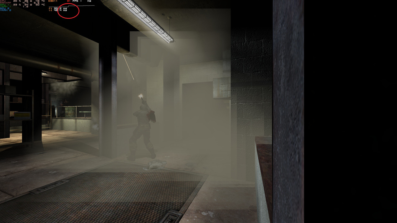

in FEAR there's sometimes a drastic fall in performance with the GPU usage contextually falling down
From 150/200 to 30 FPS:

lowenz wrote on 2025-10-14, 11:12:
in FEAR there's sometimes a drastic fall in performance with the GPU usage contextually falling down […]
Nothing to do with dgVoodoo, but in case you're unaware there's a very nice fan patch for F.E.A.R (and its expansions) now largely reducing the need for dgVoodo for those games:
https://github.com/Wemino/EchoPatch
Reply 178 of 178, by lowenz
Thanks man, still wrapping to d3d11 is needed to get HDR output (a d3d9 native HDR output implementation is possible but hard), chaining dgv2 (color space + presentation model) to SpecialK
Oh wait "FPS Drop Fix: Stops the game from initializing all HID devices as a controller to prevent framerate drops over time, rather than intercepting the call as in other fixes."....interesting
