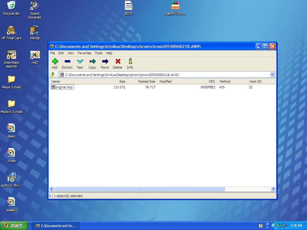

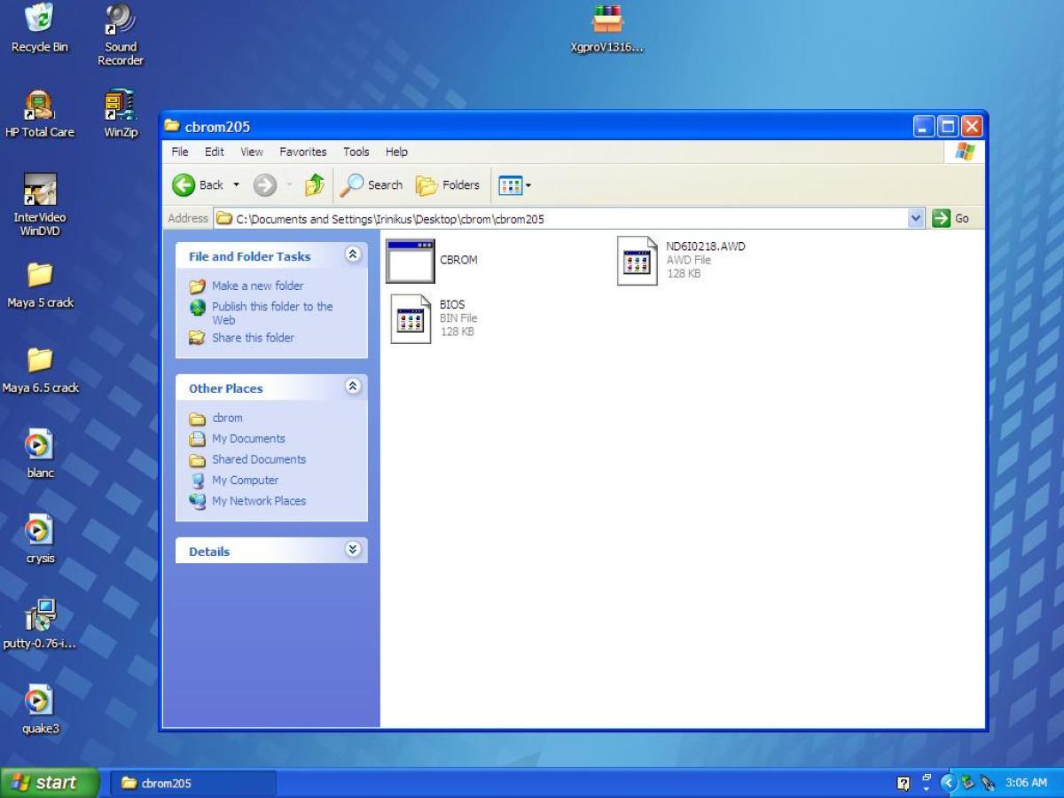

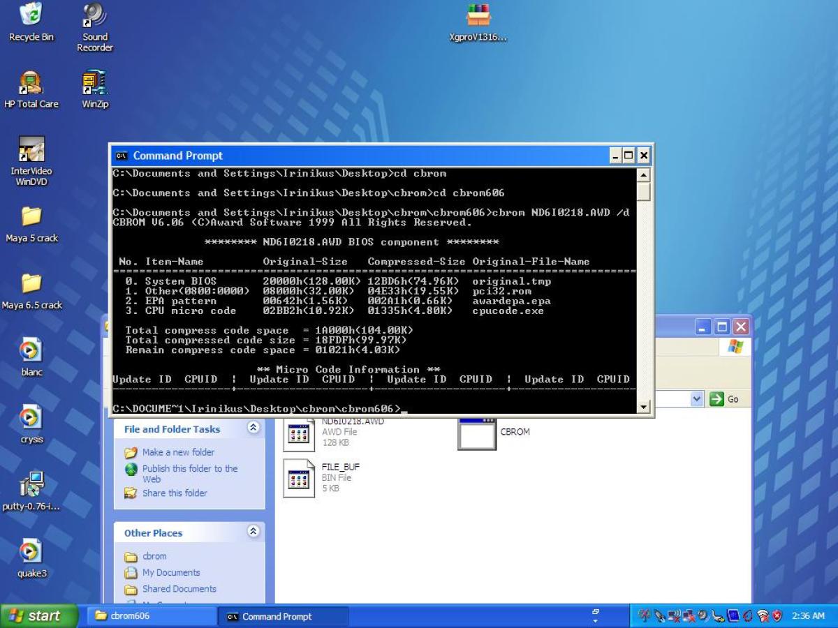

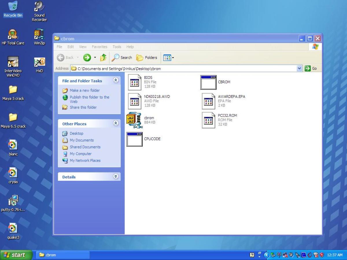

Reply 207 of 322, by Irinikus
Here's what cbrom sees inside the latest BIOS file which I downloaded for this system in an .AWD format:
This is what 7ZIP sees inside the .awd archive:
I used 7ZIP to extract "original.tmp" from the .awd archive:
I renamed "original.tmp" to "BIOS.bin"
I just want to know if I've followed the correct procedure to get a .bin file from the .awd file so that I can use it with a universal programmer?
YouTube

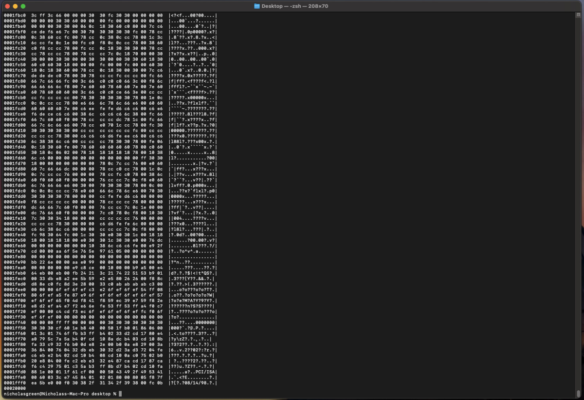

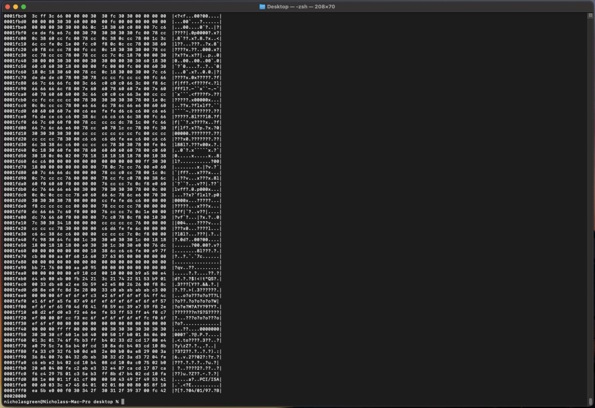

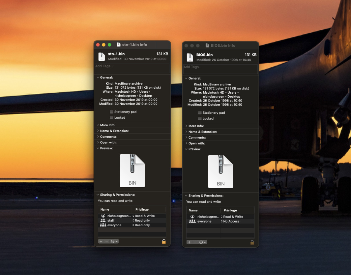

Reply 208 of 322, by Irinikus

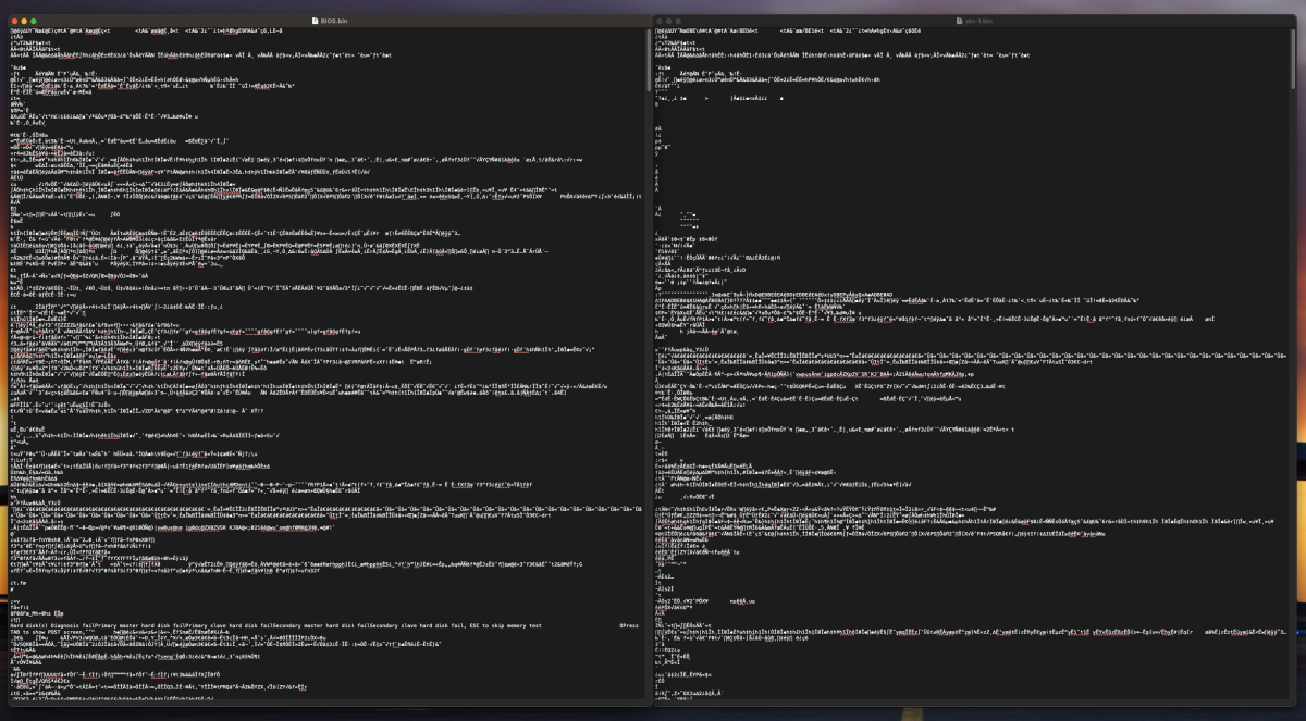

I know that this is a very crude comparison: (I opened the .bin file that I made "BIOS.bin"and compared the start and end of the file with one of the .bin files that I got for the dual pentium board from the Retro Web "stn-1.bin in text edit, and they both seem to start and end in the same way.)
Size wise they're also identical:
YouTube

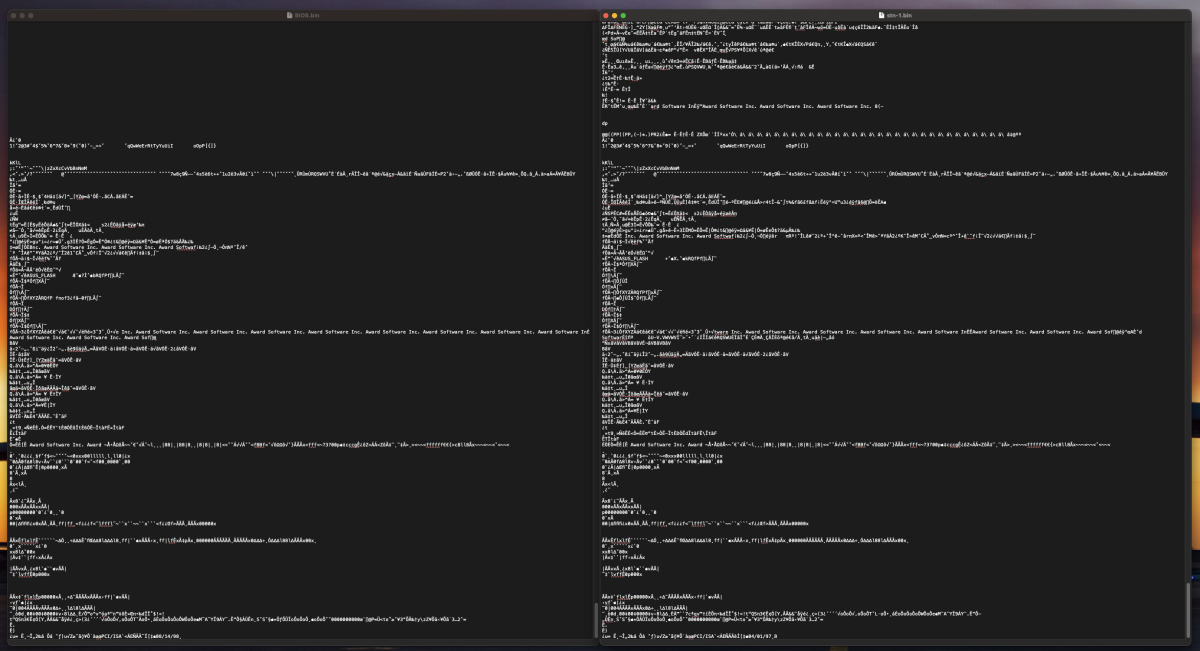

Reply 209 of 322, by Irinikus
Here's the end of the hexdump of BIOS.bin:
Here's the end of the hexdump of stn-1.bin
So hopefully I'm good! 😀

Reply 210 of 322, by Irinikus
I've managed to extract the other modules from the .AWD file: (Using cbrom)
The question is: How do I get these extra modules onto the machine when I flash the BIOS chip with a universal programmer, and what are the target ROM's for these files? (I notice that the CPU micro code if a .exe file which can probably be executed in DOS?)

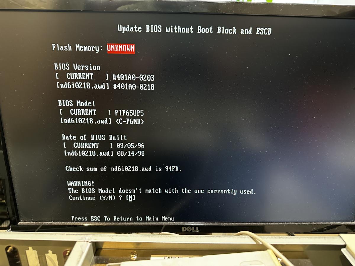

Reply 211 of 322, by Irinikus

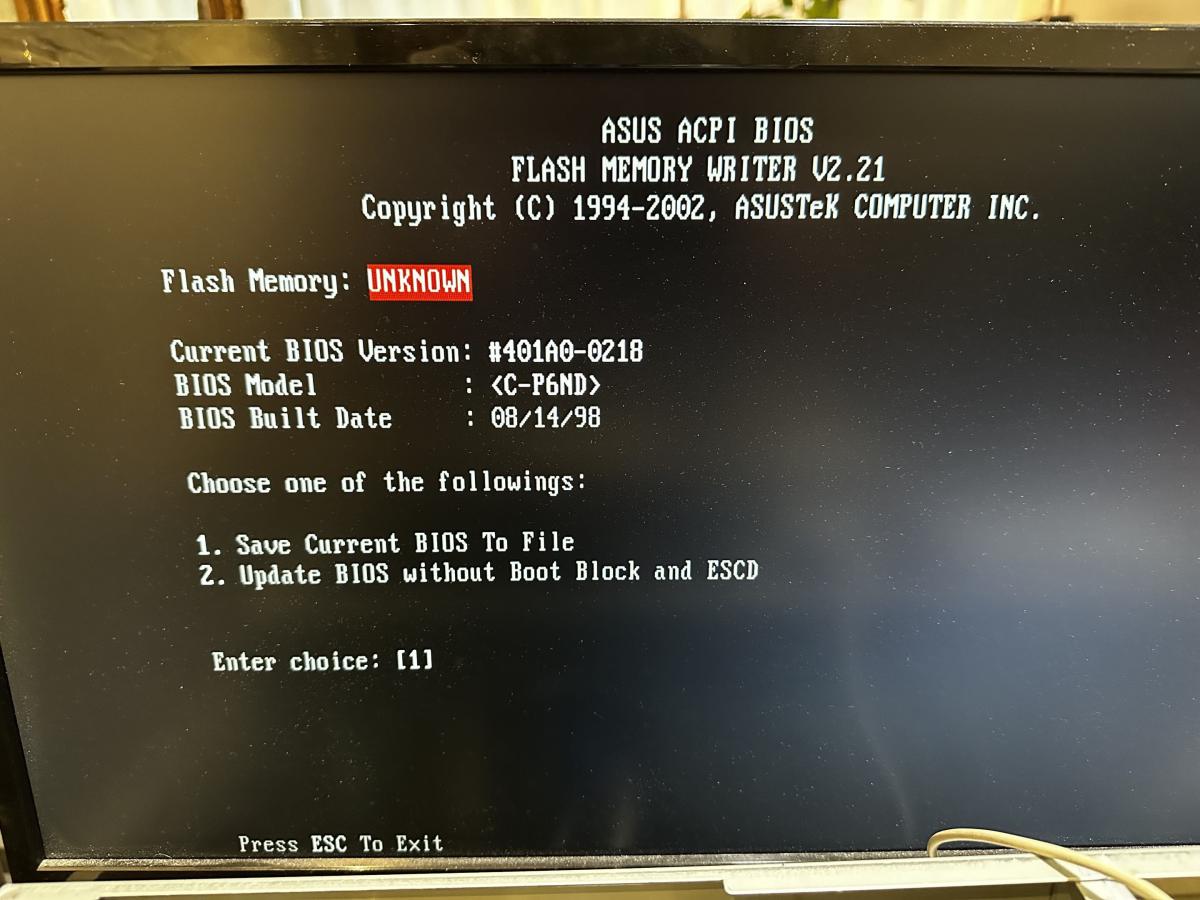

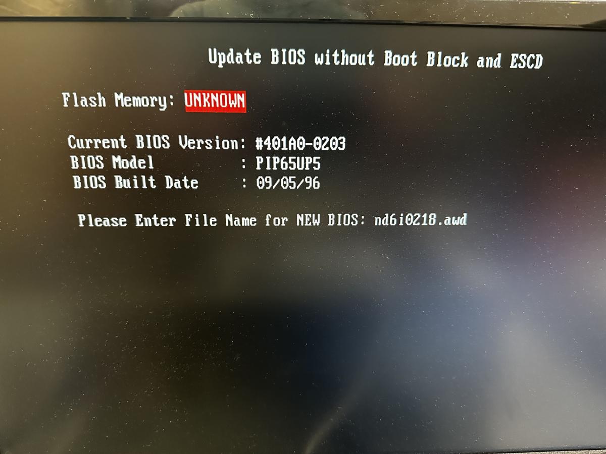

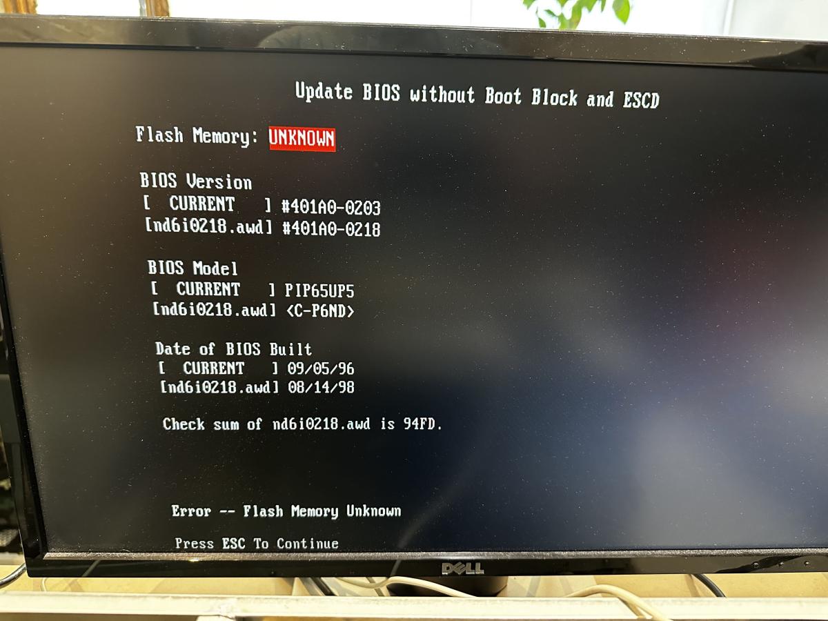

I decided to play around this morning and create a boot disk with AFLASH and the new BIOS file on it with this machine:
I was able to get into AFLASH on the Dual Pentium Pro:
And I was able to download the current BIOS
But I was unable to flash the BIOS because AFLASH couldn’t identify the Flash Memory!!!?
Just for information: C-P6ND refers to the dual Pentium Pro card.
I wonder if there isn’t a problem with the BIOS chip itself? (To be clear , the programming jumper is set correctly and the BIOS update option is enabled in the BIOS.)

Reply 212 of 322, by PC Hoarder Patrol
Irinikus wrote on 2026-06-06, 07:52:
I decided to play around this morning and create a boot disk with AFLASH and the new BIOS file on it with this machine: […]
Seen AFLASH and this 'UNKNOWN' issue mentioned a few times online - perhaps you could try PFLASH instead (copy attached plus someones usage notes)

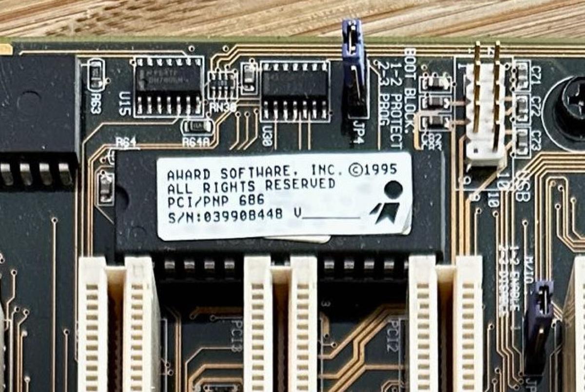

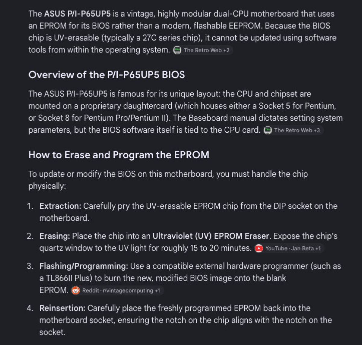

Reply 213 of 322, by Irinikus
I think I've found the problem!!!
This thing's the gift that just keeps on giving!!!!
This kind of looks like a UV-erasable EPROM to me!!!

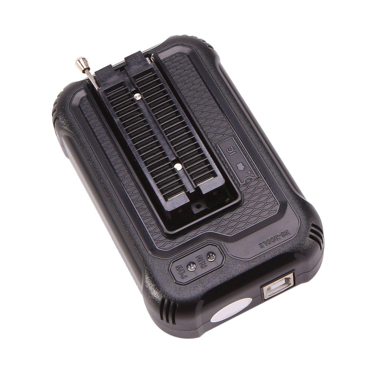

Reply 215 of 322, by Irinikus
Does anyone here know what type of EEPROM chip would be compatible with this board?
YouTube
Reply 216 of 322, by Irinikus
PC Hoarder Patrol wrote on 2026-06-06, 10:25:
Seen AFLASH and this 'UNKNOWN' issue mentioned a few times online - perhaps you could try PFLASH instead (copy attached plus som […]
The attachment pflash_16.zip is no longer available
The attachment pflash.txt is no longer available

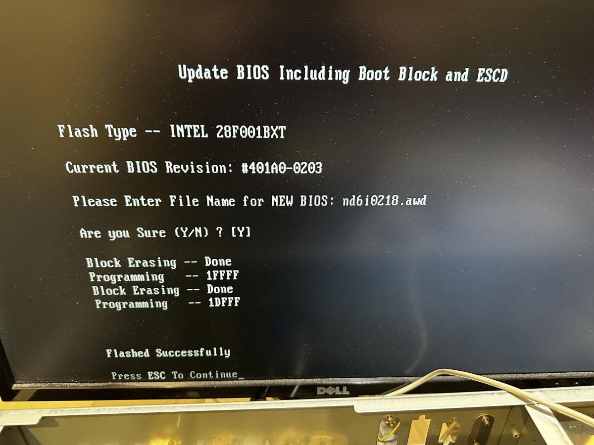

Thanks very much for the link to PFLASH, I tried it, and it worked!!! 😀
I used AFLASH to confirm that I now have the latest BIOS installed, which I now do:
So that's at least done!!!
A BIG THANK YOU TO TO YOU @PC Hoarder Patrol
YouTube
Reply 217 of 322, by PC Hoarder Patrol
Irinikus wrote on 2026-06-06, 15:24:
Thanks very much for the link to PFLASH, I tried it, and it worked!!! :) […]
Glad to help 😀 Seems Asus were aware of this general issue, based on this extract from a version of aflash.txt...
"8. If the current Aflash Utility reports
"UNKNOWN FLASHTYPE", make sure you are using the latest Aflash version,
----> "ftp://ftp.asuscom.de/pub/ASUSCOM/BIOS/BIOS_FLASH_UTILS/"
or (for older motherboards) test the following Flash utils in this order:
- AFLASH (ftp://ftp.asuscom.de/pub/ASUSCOM/BIOS/BIOS_FLASH_UTILS/ )
- PFLASH2 (v1.99)
- PFLASH (v1.6)
- FLASH (v5.3)
These Flash utils can be found at the following address:

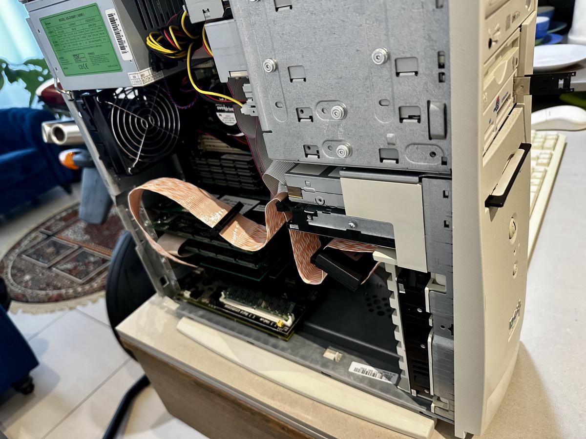

System is building nicely , so what's next.
Reply 218 of 322, by Irinikus
PC Hoarder Patrol wrote on 2026-06-07, 17:11:
The BIOS's updates at least done, but the machine is still having issues with the POST. (So I've at least eliminated the possibility of there being a corrupted BIOS)
The next move I'm going to have to make is to wait for my PCI/ISA Diagnostic card as well as some DeoxIT to arrive, so that I can clean all of the contacts as well as the CPU sockets and then check to see where it's hanging up during the POST.
I might also try dropping the CPU frequency for now to see if it has any effect. (Maybe helping to confirm that the VRM's need a re-cap)
I think that the Base Board as well as the CPU card are both going to need a re-cap. That will only be tackled next year when I get my JBC rework station, as that's going to cost me $6380 without shipping and taxes.
YouTube
