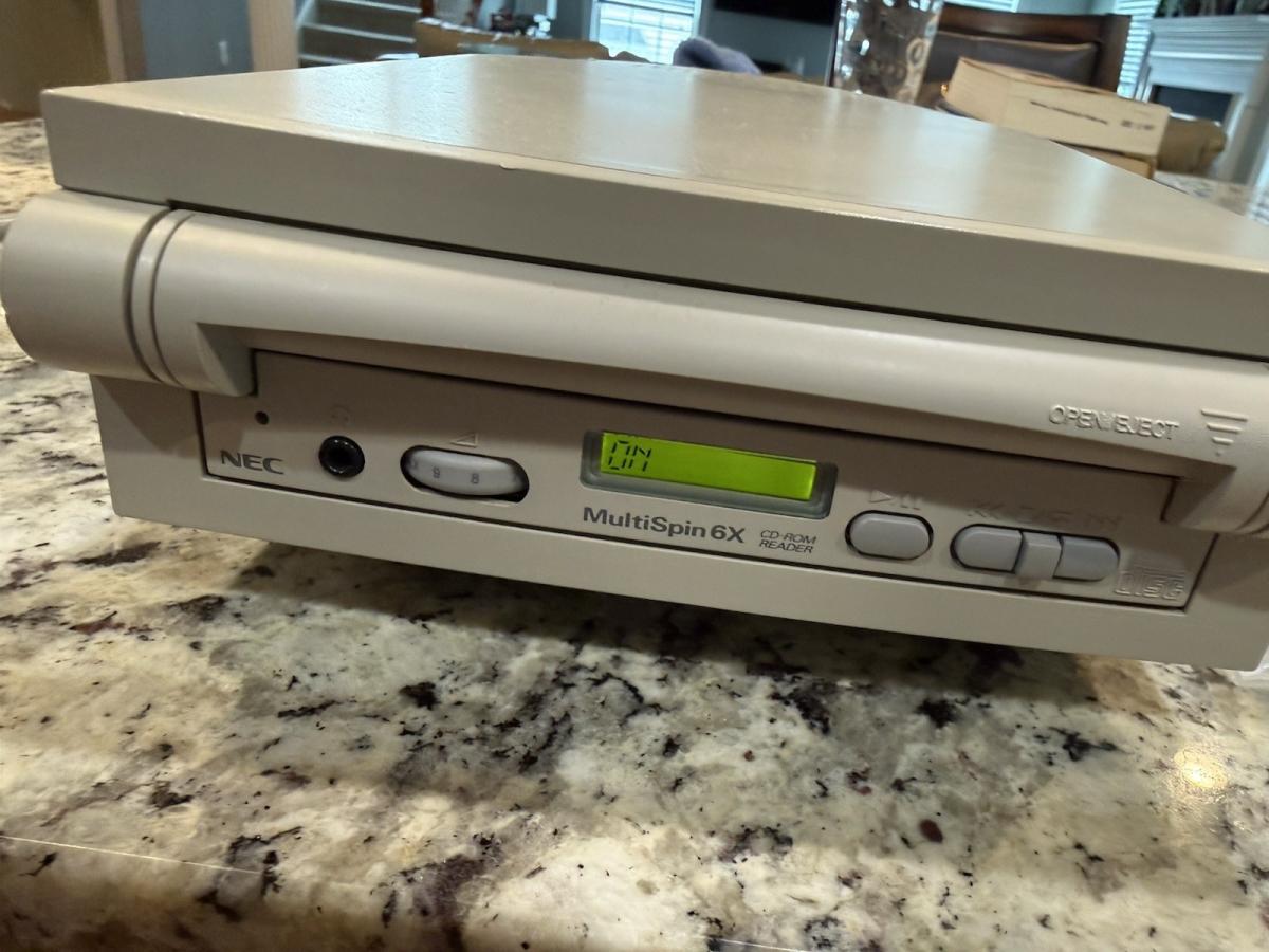

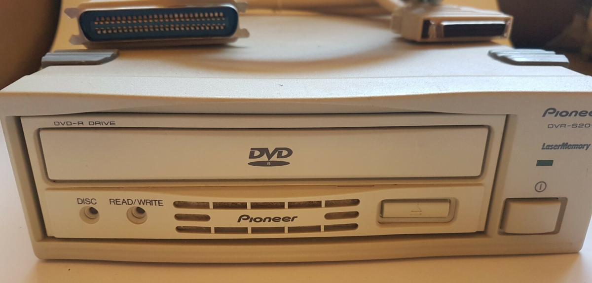

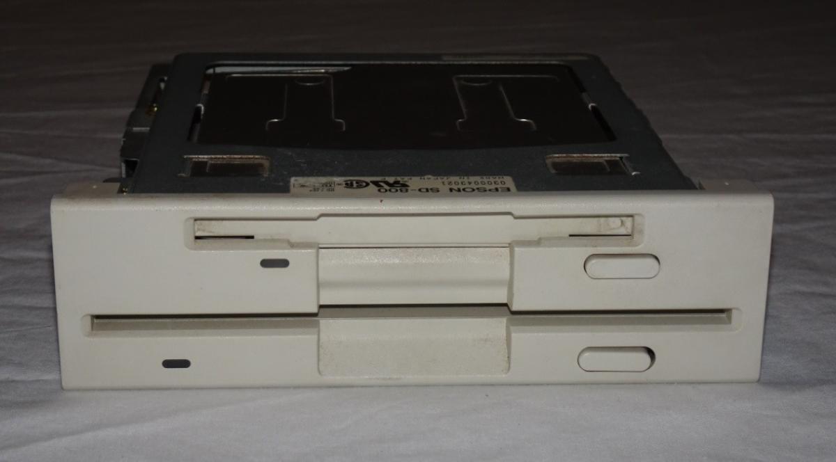

Here's some of the removable media that I'm considering for this system:
Epson SD-800 3.5" and 5.25" Combo Floppy Drive :
Pioneer DVR-S201 Professional SCSI DVD-R Authoring Drive:
NEC MultiSpin 6X SCSI CD-ROM Drive
I'll more than likely have to order the two optical drives as external units, and then remove the drives from those enclosures and fit them into the system.
The Pioneer's claim to fame is the fact that it was the first commercially available DVD writer.
The NEC's a really cool looking Caddy drive.
