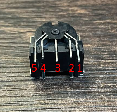

Lets use proper pin numbering. 386 no keyboard response, pinouts checked weird?
This is Wrong:
PC AT DIN 5 pins go like this https://sharktastica.co.uk/topics/keyboard-co … tors#DINPinouts:
Your
54321 becomes
14253
so your
>KB Connector Pin1 - NC to KBC (directy).
NC, good. What do you mean by "to KBC (directy)"?
>KB Connector Pin2 - KBC Pin: 40, 26, 25.
5V, good
>KB Connector Pin3 - KBC Pin: 39.
Data, good
>KB Connector Pin4 - KBC Pin: 2, 7, 20 and (mainboard GND).
GND, good
>KB Connector Pin5 - KBC Pin: 1.
Clock, good
But this might not be all. Traditional Keyboard Controllers also need at least two output buffers connected to pins 37 38 like here
https://alexandrugroza.ro/microelectronics/sy … c-schematic.png
or here page 3 https://github.com/skiselev/mb386sx-rc2016/bl … hematic-1.0.pdf
AND most importantly two pullup resistors. Keyboard protocol uses open-collector wiring, meaning both KBC and keyboard signal by shorting data/clock wires to ground. This works because both Clock and Data are pulled up by resistors.

ergo when you say
>Measured voltage on the keyboard connector.
you are measuring something else because you numbered your pins weird? 😀
JAKra85 wrote on 2026-09-04, 11:38:During boot it is near and around 0V a little above 0V (~0.2V).
WHICH PIN did you measure? and How did you measure? normal multimeter is too slow to notice, will have high hysteresis and will show you average from last ~second.
Im guessing you were measuring pins 1 and 2 clock/data, your pinout would be 3 5. This is perfectly normal.
