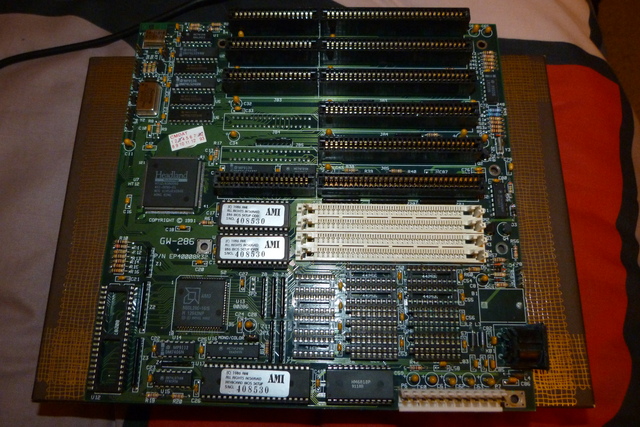

I've been on with this for some time now - this system is based on the actual motherboard from my very first PC, bought around 1991-1992. So it has quite a lot of meaning for me.
The board has been stored ever since my first upgrade (a 386SX-40) and I forgot about it
It's a no-name board (well, it has 'GW-286' on it, but I can find no link to an actual board that matches it), but is a very late 286 design with:
4x SIMM slots (though there are sockets for 44256 and 41256 too)
4x 16bit ISA
2x 8bit ISA
surface mount AMD 286-16 CPU
socket for 80287 FPU
After 'rediscovering' the motherboard again I removed the cmos battery as it was just starting to leak (pins on nearby battery header were starting to go green, but no corrosion of tracks on the board, luckily!).
Virtually all of the discrete chips found in early boards are replaced by a single large surface mount "Headland HT12" chip, so it's a very compact and neat baby-AT layout.

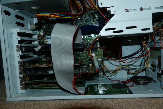

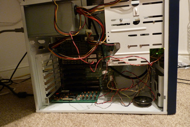

After months I finally found an AT case and cleaned it up to install the board.
I also acquired the following parts:
4x 1Mb SIMM's
16bit 1Mb Cirrus Logic GD5428 VGA card
16bit WDC chip multi-IO card (card is a no-name)
8bit Roland MPU-IPC-T MIDI interface + breakout box
Just trying to get it to boot - VGA card only:
All cards installed. From bottom to top: CL5428 VGA, 3com 3C509B NIC, Creative SB16, Roland MPU-IPC-T, multi-IO card:
Case refurbished and LED speed display matched to clock speed:

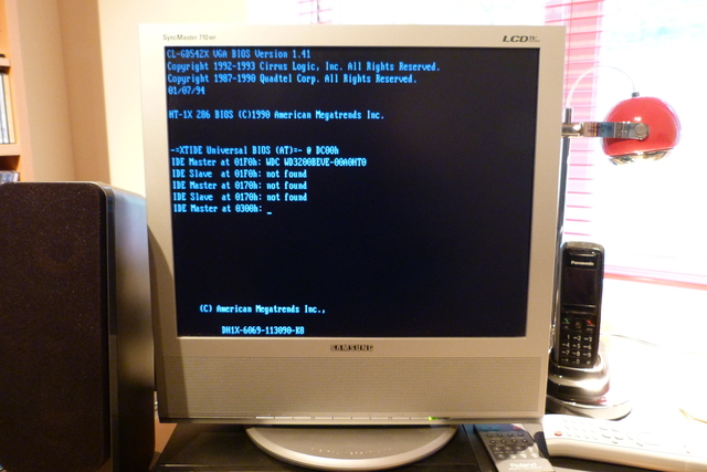

IDE Drive Support

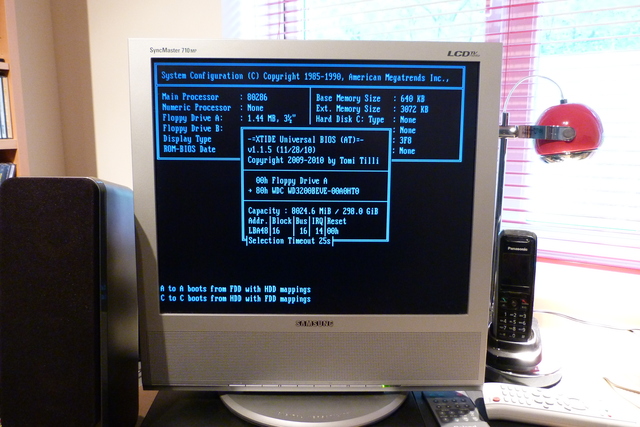

The next issue was getting the BIOS to recognise any sort of modern IDE drive. IDE controllers of this era were pretty much dumb devices and relied on the IDE support built in to the motherboard BIOS to support different drive types and volumes. My first attempt to get around the disk issue was to use an Adaptec AHA-1542 SCSI card and a SCSI-IDE bridge... but that didn't work (ISA DMA issues with the SCSI card and a complete lack of detection with the SCSI-IDE bridge adapter).
The next thing to investigate was the XT-IDE project who have produced an IDE BIOS and 8bit card to go along with it, to allow XT class machines to use modern IDE devices up to 8GB. However, the XT-IDE BIOS is also capable of being hosted in a lot of other ISA cards with boot rom support - such as my Adaptec SCSI card... so after downloading the XT-IDE BIOS and burning it to an eprom, I tried it in my SCSI card. No luck. Thankfully I also had an old 3Com 3C509B network card with boot rom support, so I tried it in there. No luck either. I was about to go out of my mind at this point, but fortunately my thread on vintage-computer.com threw up an issue relating to the checksum of the BIOS. As soon as I had a BIOS image with the correct checksum it instantly detected my IDE drives.
I'll just re-iterate this - the XT-IDE BIOS image, hosted in a socket on a 3Com network card correctly detected the IDE devices plugged in to the primary channel on my boggo standard multi-io card. This was a huge result!
Over the next few days I did several installs of DOS, on several different drives and found the following:
4GB Kingston Elite Pro 133X CF Card with MSDOS 5 : Quick, booted ok. Hit and miss loading Norton Sysinfo (sysinfo.exe) and edit.com.
4GB Kingston Elite Pro 133X CF Card with MSDOS 6.22 : Slower boot. Directory navigation slow. sysinfo.exe wouldn't load, edit.com froze accessing menus, mem wouldn't run.
8GB Transcend 133X CF Card : Similar results to the Kingston. Faster than Kingston was with MSDOS 6.22. Occaisional boot would fail.
10GB IBM Travelstar IC25N010ATDA04-0 with MSDOS 5 : Formats and installs OK. Would not boot.
320GB Western Digital 3200BEVE with MSDOS 5 : Very fast. Installs ok. Boots ok. No issues loading any programmes.
Clearly I don't need a disk as big as 320GB with DOS, but this is quiet (a 2.5" drive), fast, and doesn't appear to have any issues. It was also a spare from a slim PS2 HD project.
So, here's what the XT-IDE BIOS looks like:

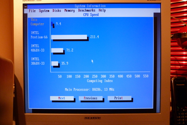

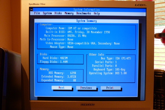

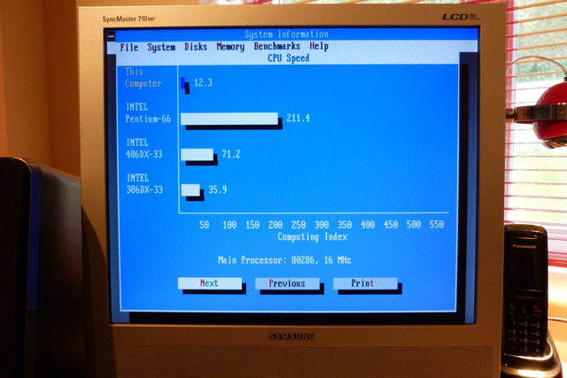

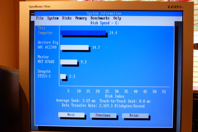

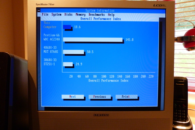

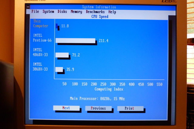

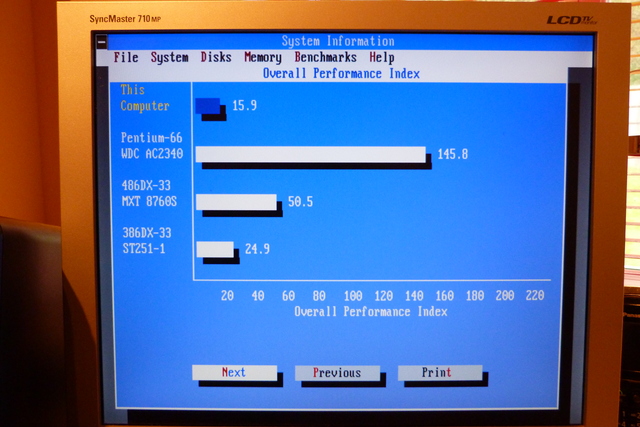

Speed Results
Any some info from Norton Sysinfo with default BIOS options:

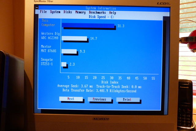

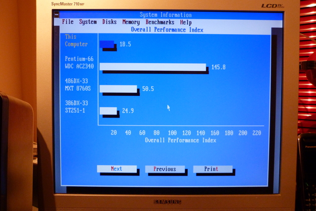

... And here is what difference turning on 'Fast ISA Bus' and '0 Wait State' BIOS Options does:
I'd say that was a 286 that was giving a damn good effort!

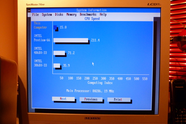

Tweaking!

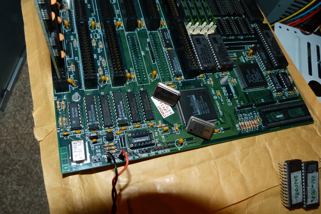

In a fit of madness I desoldered the 32MHz clock crystal from the motherboard (divided by 2 to get 16MHz) and put a 14 pin DIL socket in it's place. I've tried a couple of replacement clocks:
... 56MHz (equals 28MHz), 50MHz (gives 25MHz) and 40MHz (20MHz CPU speed). The closest one to working is the 40MHz oscillator - I can get the system to boot, but reading from disk generates rubbish - I suspect the ISA bus is over spec, even with the 'Fast ISA Bus' option disabled. I don't know how/where the ISA bus divider is set, so unfortunately this didn't accomplish what I was hoping for. I might try with a 36MHz or 38MHz oscillator (18 or 19MHz), if I can pick one up cheap to try.
So what is it like to use? Well, actually it's pretty nippy in terms of general directory navigation and starting up games/utilities. I've tried a few games so far, including:

Reply 7 of 23, by DonutKing
Nice system 😀
On many of these old boards I've noticed there are two oscillators, one for the CPU and one at 14MHz, which I assumed was to clock the ISA bus seperately at 7MHz... yours has one too, in the lower left corner (in a 3-pin package unlike the others you have in that photo).
maybe this oscillator is for something else entirely?
Yep. That's true - I guess I just don't know how it works the divisor out from the cpu clock (which, when I install the 40MHz oscillator instead of the 32Mhz one speeds the POST, memory test and boot dramatically!). There could be a signal line from the chipset that feeds the ISA bus at 2/3, 1/2 or 3/4 of that seperate clock depending on the cpu clock - I just don't know.
It must be selectable though through some control line or something though, as the BIOS option to enable 'Fast ISA Bus' lists 8MHz as the default option.

Couple more performance stats:
Running at 20MHz (40MHz oscillator). Have to boot with turbo disabled (slooooow), and then re-enable while the sysinfo.exe is running:
Interestingly IDE performance drops - likely because the ISA bus is too highly clocked at whatever divisor it uses from the 20MHz cpu frequency:
The lower disk performance drops the overall score to the same as 16MHz + Fast ISA Bus result in my first post.
I tried again with a 50MHz oscillator (which would give 25MHz cpu clock). I only succeeded in booting with turbo disabled. As soon as turbo is turned on it locks up. Pity. Anyway, here's at 13MHz (turbo disabled):
