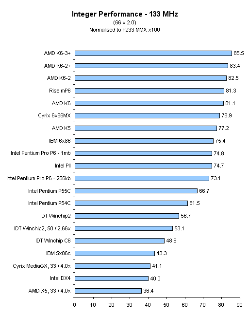

Test numbers used for the Integer average:
3, 16, 18, (28, 34), 51, 52, 53, 56, 58, 61, (67, 69), and (79-82)

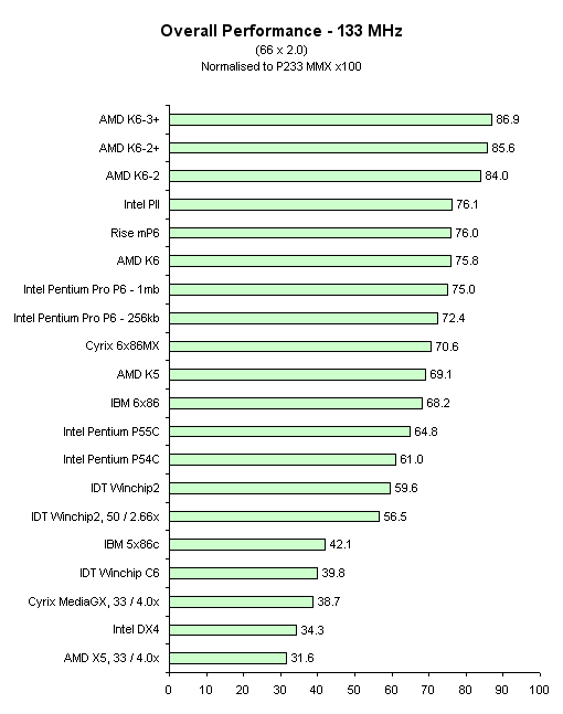

Test numbers used for the Overall average:
3, 16, 18, (28, 34), 51, 52, 53, 56, 58, 61, (67, 69), (79-82), 2, 17, (4, 19), 54, 55, (59, 60), 62, (68, 70), (83-86), 88, (90, 96), 98, 1, 31, 46, and 75
These test numbers are also indicated by an I, F, or O on the first page of the raw and normalised data tables. I for Integer, F for floating-point, and O for overall.
The instances of (x, y) indicate that x and y results were averaged. This is needed for cases whereby two tests were utilised from a single benchmark suite. Not averaging these values would give more weight to a specific benchmark program. For the Overall average score, some benchmark pairs needed to be averaged to reduce the number of floating point tests to equal the number of integer tests. In this way Integer and Floating-point tests are given the same total weight for the Overall average.

From the raw and normalised data tables, a simpler table was created to more easily identify the results for Integer, Floating-point, Overall, Quake 1, Quake 2, Quake 2 - OpenGL, Doom, PassMark - MMX, and 3DMark99Max. This table can be found under the heading SELECT BENCHMARK RESULTS - LISTED BY CPU. The results from this table are then rearranged in descending order based on benchmark score under the heading INTEGER PERFORMANCE - RANKED IN DESCENDING ORDER, and continued for Floating-point, Overall, Quake 1, Quake 2, etc.

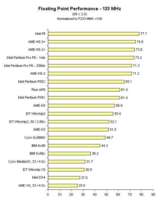

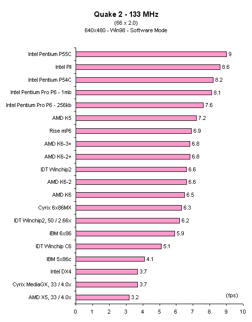

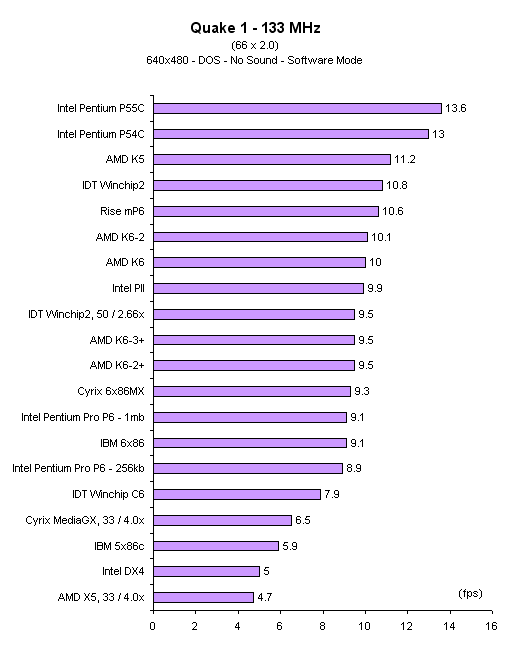

Following the tables are bar charts containing 20 different CPUs - all run at 133 MHz. These charts give a quick means to compare the performance of different CPU architectures on a clock-for-clock basis. These charts offers a quick means to estimate if, for example, a Pentium II outperforms an AMD K6-2 at any mutual frequency. If the PII scores better than the AMD K6-2 at 133 MHz, it is also likely better at 450 MHz. The FSB and multiplier used for the 133 MHz comparison is assumed to be 66 x 2, respectively, unless noted otherwise on the charts.

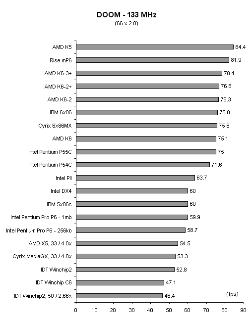

● Doom v1

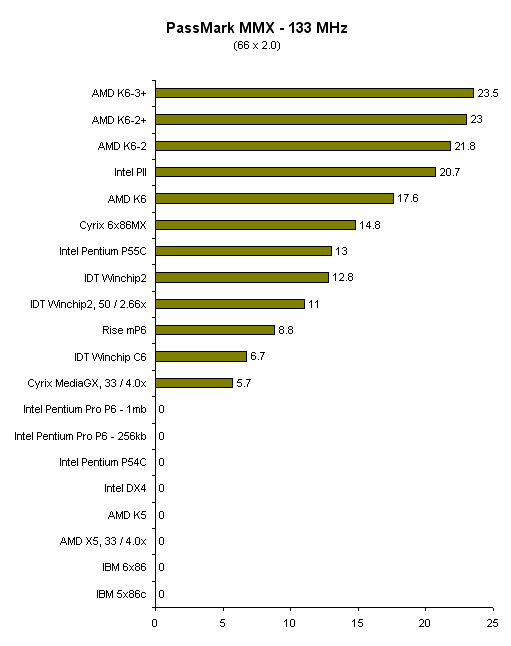

● PassMark v4.0

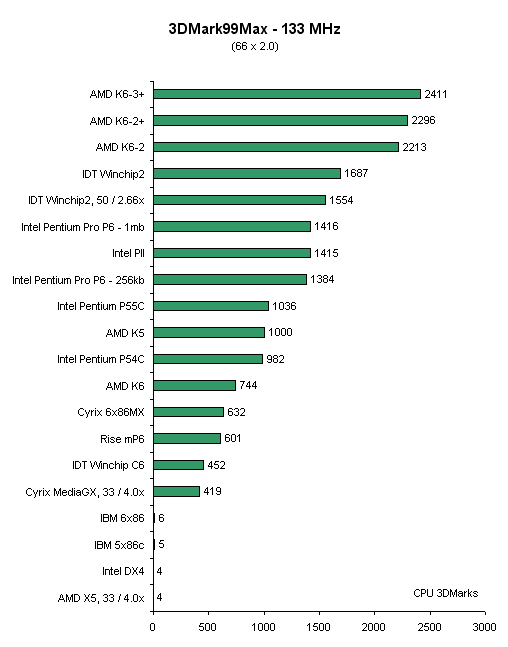

● 3DMark99Max @ 800x600

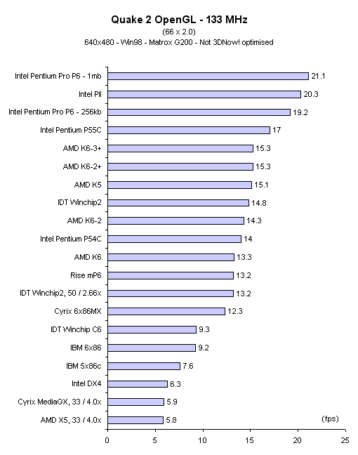

● Quake II v3.20* @ 640x480
* FastVid was not enabled for testing. Enabling FastVid may increase highly graphic DOS-based benchmark scores, such as 3Dbench and Doom, when using a Pentium Pro, Pentium II, or Pentium III CPU.
* Note that the 3DNow! patch for Quake II was not used. The knowledge of this patch came after all results were tabulated This patch allows Quake II to utilise 3DNow! instructions and greatly improves the frame rate for 3DNow!-enabled CPUs. For this study, the CPUs which would benefit from this patch are the AMD K6-2, AMD K6-3, AMD K6-3+, AMD K6-2+, IDT WinChip2, and AMD Athlon. There are reports that applying the patch increases frame rates on an AMD K6-2 by ~20%.

Quake 2
timedemo 1
map demo1.dm2
DOOM
doom -timedemo demo1
gametics/realtics*35

Clock-for-clock comparison at 133 MHz.

Clock-for-clock comparison at 133 MHz continued...
The full pdf report contains all raw data in printer friendly form.

I'm pretty impressed with the K6 2/3 FPU performance. Seeing as it was meant to be pretty bad I think it has done very well.
I'll need to do some more testing of my own but it looks like the higher end K6 2/3s can easily beat the low end P2s, which I think is pretty cool.
My benchmarks of choice are a bit newer, Quake 3 and 3DMark 2000/2001se, so the K6s might perform different in these apps.
Great work, I'll be reading it more in the next few days.

man, Pentium pro overdrives are AWESOME chips... Something doesn't sit right with me on the quake 1 results though. I'm going to run that once more and double check. for some reason not only are those chips WINNING but beating chips 2x as fast in mhz. honestly i'd expect to see them just under the p2 xeons.
unless quake 1 dos loves p2-overdrives...

Thank you for this data.
Here is the data in terms of percent increase for the 3DNow! patch.
Quake II @640x480 - Software Mode
AMD K6-III-300 (4.5x66): 26%
AMD K6-III-300 (3x100): 31%
AMD K6-III-500 (5x100): 23%
AMD K6-III-510 (5x110): 22%
AMD K6-II-300 (3x100): 28%
AMD K6-II-475 (5x95): 21%
Quake II @640x480 - OpenGL
AMD K6-III-300 (4.5x66): 17%
AMD K6-III-300 (3x100): 15%
AMD K6-III-500 (5x100): 18%
AMD K6-III-510 (5x110): 13%
AMD K6-II-300 (3x100): 18%
AMD K6-II-475 (5x95): 15%
The slower CPU speeds show greater benefit from 3DNow! I wonder how much increase the Winchip2 would show?
Do you think it would be of value to patch the Quake II charts to reflect these percent increases? EDIT: Actually, this would also alter the FPU and Overall charts, as well as the RAW/Normalised data tables.
Reply 11 of 148, by F2bnp
Well, it will probably be too much of a hassle for just this one game. AMD made some pretty heavy tweaks to Quake 2 to really show off the power of 3Dnow!
But it's just Quake 2, I don't think there's really any other game that shows such improvement.
So in the end, its your call. I just found it fun to do these tests 😁.
