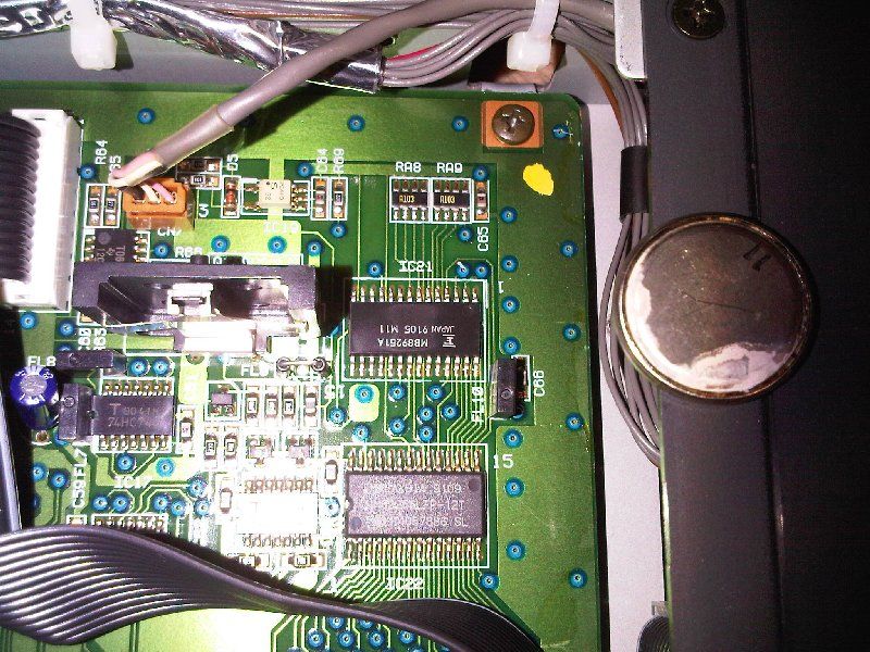

Postby keropi » 2013-7-31 @ 11:57
... well you should!
This is what I faced when I opened the SC-55 I received today:
A leaking CR-2032 battery! :exclamation: Fortunately the plastic holder prevented the acid from reaching the pcb...
Might worth to check your units, it would be a shame if they developed faults because of the battery. The situation is not as serious as the NiCad batteries that have killed countless mobos/amigas/etc , but still! Better safe than sorry :blush:

For this reason I replaced my battery in my SC-55 last month. If you aren't planning on using the battery functionality, you should just be able to remove it and leave it empty.

Postby keropi » 2013-7-31 @ 20:43
Great Hierophant wrote:For this reason I replaced my battery in my SC-55 last month. If you aren't planning on using the battery functionality, you should just be able to remove it and leave it empty.
aha! I think I'll do just that, all I want to use the sc-55 is for some "serious" gaming sessions :blush: :blush: :blush:

Postby Shagittarius » 2013-8-01 @ 00:14
Thanks, I just checked mine 5 minutes ago, it was fine but I removed it for safety. In the mkII the battery holder is horizontal.
