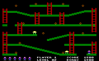

Reply 16 of 20, by robertmo
when i set machine=cga and choose composite monitor in game i have at least 9 colours: white, yellow,orange,red, gray(robot's hands), light green, dark green, dark blue, violet and (black)

Reply 17 of 20, by taiken7
Thats almost exactly what PcJr setup does.. good work there Rob 😎
(it tweaks CGA registers / selecting composite-tv output)
Ok, so now the other easter egg is the groovy tunes -- still not sure
how to get these going, it seems if you hard code a few things others break; dosbox freezes at 'Query_Joystick' following --
search replace "26803EFEFFFD 74 1D" with "26803EFEFFFD EB 1D"
ie 0:3E0d5 = was "74" now "EB" (mnemonic "JE" becomes "JMP")
