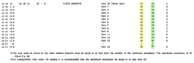

Reply 51 of 201, by James-F
Here is a nice experiment:
The attached Midi file "Seasons" is part of the Windows 95 test midis.
This little midi breaks the 28 sounds Polyphony capabilities of the SC-55 units and the last 3 instruments are cutting on and off.
The strange thing is that in this midi the main lead instruments are on channel 13-15.
I found that the default "Voice Reserve" settings on the SC-55 give 6 sounds to channel 1, and 2 sounds to channels 2-10, while channels 11-16 have 0 voice reserve.
28 simultaneous voices for the SC-55 MKII (24 for the MK1). *Page 56 in the SC-55 MKII manual is about Voice Reserve, p.98 for defaults.
I tried to find info about Voice Reserve in the SC-88 (64 sound polyphony), but there is none.
Roland completely removed this feature from SC-88 and on, apparently because 64 note polyphony was enough to remove the necessity of managing it.
Try to play it on your SC-55.
Basic as it may, it breaks the SC-55 polyphony limit. 😀

Reply 55 of 201, by James-F
Daeuuummm nice setup Cloudschatze.
Each instrument uses only 1-2 voices, so the 64 voices that the SC-88 supports is always sufficient.
You assume that a composition plays only 2 notes at a time in a part.
I can play 10 note chord with both hands and that's already 10 voices on one channel.
A midi file is not limited to 10 fingers, it can play 64 notes on one channel, maximizing the polyphony of any Sound Canvas in one part.
EDIT:
Furthermore, if I play 1 note fast with a slow tone I can exceed the polyphony, because the sound is still playing even after the note is released.
* After "Note Off" command some sounds continue playing like "Tubular Bells" (or simply using the Sustain control).
So polyphony is about simultaneous SOUNDS not notes or midi messages.
It's more complicated than that on the SC-55.
There's "Part Priority" and "Note Priority (voice reserve)".
Note Priority has priority over Part Priority when you reserve notes to that part even if it is the last part (16).
Part Priority will have priority if there is no Note Priority.
All in ascending order... so it's complicated.
Try to set as following Voice Reserve (Note Priority):
Channel 1-13 to 0.
Channel 14 to 8.
Channel 15 to 8.
Channel 16 to 12.
Now play the infamous Canyon.mid. 🤣
Even though there is priority to the parts in ascending order, all the note priority is distributed to the last parts.
    canyon.zip
    13.61 KiB
    106 downloads

I have a CLEAR example where the polyphony (or rather the "Voice Reserve" distribution) of the SC-55 MKII (28) is not enough, on the MKI even more so.
It's from Warcraft 2! 😲
It was composed on the SC-88 and the polyphony of the SC-55 is not enough for some of the tracks.
It's the most played midi game track next to Doom and Duke3D on the SC-55... the irony.
The SC-55 has low polyphony (28) and it uses something called "Voice Reserve" to distribute and prioritize the available polyphony across the channels.
BUT the default values (each reset) are totally wrong and reserve nothing for the 11-16 channels, making them cut off the sounds on many midi files if tracks 1-10 take all 28 available sounds.
The only way to change the Voice Reserve for each channel is by sysex or front panel.
Roland completely removed the "Voice Reserve" function from SC-88 and on, because 64 polyphony was enough not to bother with the distribution of it across the channels.
Here is the Warcraft 2 example on a real SC-55:
https://www.youtube.com/watch?v=0ndCckv-lww
You can hear in the first 10 second that the Bell cuts off (its on channel 13), but 10 seconds on it plays fine.
For 20 year nobody noticed! 🤣
*I attached the midi.
PS. I made the same post at the Falcosoft Midi Player, so it will have the option for a custom SYX reset sequence for the SC-55 for better "Voice Reserve" each reset.
    HUMAN1GM.zip
    11.91 KiB
    125 downloads
Reply 59 of 201, by James-F
I have written a sysex message for custom Voice Reserve to all channels as I think it would be ideal for the SC-55 MKII, and a GS reset right before that.
It works. 😀
Basically I distributed the faulty default voice reserve settings across all channel more equally.
Why Roland chose to use only 24 reserved voices in the MKII and eliminate channels 11-16 completely is a mystery...
No channel left without at least 1 voice reserved, I used all 28 voices across all channels.
No more instrument cut offs in Warcraft 2 and in the previous midis I posted. 😀
F0 41 10 42 12 40 00 7F 00 41 F7
F0 41 10 42 12 40 01 10 02 02 02 02 02 02 02 02 02 02 02 02 01 01 01 01 13 F7
Yellow is default, Green is my configuration.
